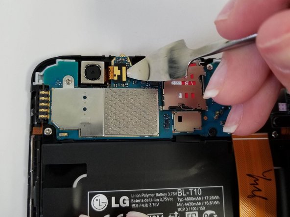

  3. LG G Pad 8.3 4G Back Camera Replacement, Back Camera: crwdns2935265:03crwdnd2935265:01crwdnd2935265:02crwdne2935265:0 LG G Pad 8.3 4G Back Camera Replacement, Back Camera: crwdns2935265:03crwdnd2935265:02crwdnd2935265:02crwdne2935265:0
    • Place metal spudger under edge of the IT1430 and lift vertically.
    • The IT1430 looks like a small cube with a yellow bar hanging off the side.

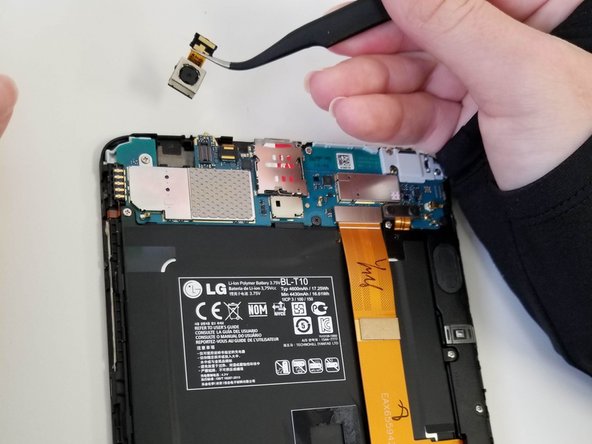

  4. LG G Pad 8.3 4G Back Camera Replacement: crwdns2935265:04crwdnd2935265:01crwdnd2935265:02crwdne2935265:0 LG G Pad 8.3 4G Back Camera Replacement: crwdns2935265:04crwdnd2935265:02crwdnd2935265:02crwdne2935265:0
    • Insert spudger to the right edge of the gold band and gently pry it up to disconnect the chip.
    • Repeat step with top and bottom sides.
    • Remove with tweezers.
    • Be careful when inserting the spudger behind the gold band because it is possible to tear it.
