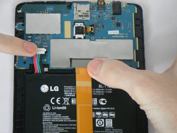

  2. LG G Pad 7.0 Display Assembly Replacement, Connectors: crwdns2935265:02crwdnd2935265:01crwdnd2935265:03crwdne2935265:0 LG G Pad 7.0 Display Assembly Replacement, Connectors: crwdns2935265:02crwdnd2935265:02crwdnd2935265:03crwdne2935265:0 LG G Pad 7.0 Display Assembly Replacement, Connectors: crwdns2935265:02crwdnd2935265:03crwdnd2935265:03crwdne2935265:0
    • Remove the red marked connectors by gently prying up. Be sure not to rip the ribbon cables as they are very fragile.
    • You will have to remove the metallic tape near the bottom of the tablet to disconnect the display cable.
    • Remove the three connectors marked in orange by gently prying them upwards. The cables are very fragile so be careful not to rip them.

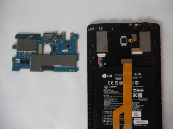

  3. LG G Pad 7.0 Display Assembly Replacement, Logic Board: crwdns2935265:03crwdnd2935265:01crwdnd2935265:02crwdne2935265:0 LG G Pad 7.0 Display Assembly Replacement, Logic Board: crwdns2935265:03crwdnd2935265:02crwdnd2935265:02crwdne2935265:0
    • Remove the 7 screws marked in red that are securing the logic board to the case.
    • Be sure that all the connectors marked in orange are removed before pulling out the mother board.
    • Very carefully remove the logic board after the screws have been removed

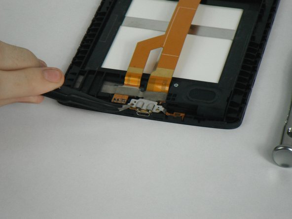

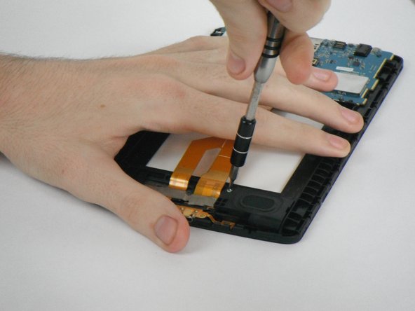

  4. LG G Pad 7.0 Display Assembly Replacement: crwdns2935265:04crwdnd2935265:01crwdnd2935265:03crwdne2935265:0 LG G Pad 7.0 Display Assembly Replacement: crwdns2935265:04crwdnd2935265:02crwdnd2935265:03crwdne2935265:0 LG G Pad 7.0 Display Assembly Replacement: crwdns2935265:04crwdnd2935265:03crwdnd2935265:03crwdne2935265:0
    • Remove the two screw marked in red.
    • Using the tweezers , gently pull out the metal bracket that holds the charging port in place.
    • Carefully pull out the ribbon connector in orange.
    • Remove the one screw that holds the speaker in place.
    • Slowly pull out the speaker.
  5. LG G Pad 7.0 Display Assembly Replacement: crwdns2935265:05crwdnd2935265:01crwdnd2935265:02crwdne2935265:0 LG G Pad 7.0 Display Assembly Replacement: crwdns2935265:05crwdnd2935265:02crwdnd2935265:02crwdne2935265:0
    • Insert your new mother board with the 7 screws
    • Reconnect all the connectors marked in red back to the mother board.
