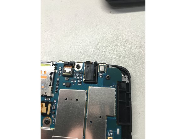

    • After removing the faulty/dead battery, make sure you properly dispose it.
  10. LG G Pad 7.0 Battery Replacement, Don't Forget!: crwdns2935265:010crwdnd2935265:01crwdnd2935265:02crwdne2935265:0 LG G Pad 7.0 Battery Replacement, Don't Forget!: crwdns2935265:010crwdnd2935265:02crwdnd2935265:02crwdne2935265:0
    • After reconnecting the new battery and charging flex cable, make sure you put the headphone jack back into place.
    • There you go! A quick battery replacement on your LG G-Pad.
