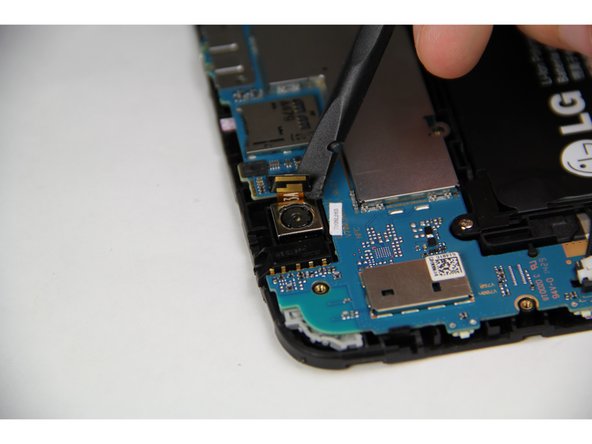

    • Using the spudger, pry up the connector on the motherboard from the back camera to disconnect it.

    • Then move to the front camera towards the end of the motherboard and disconnect that by using the spudger to pull up on the clip.
  10. LG G Pad 10.1 Speaker Replacement: crwdns2935265:010crwdnd2935265:01crwdnd2935265:01crwdne2935265:0
    • Now that all of the wires and screws are disconnected, use the spudger or a prying tool on the bottom corner of the motherboard to release it from one of the clips holding it in place.
  11. LG G Pad 10.1 Speaker Replacement: crwdns2935265:011crwdnd2935265:01crwdnd2935265:01crwdne2935265:0
    • Once the corner is removed, repeat the same action at the far end of the motherboard to release the second clip.

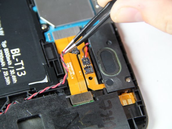

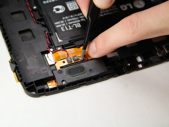

  12. LG G Pad 10.1 Speaker Replacement, Speaker: crwdns2935265:012crwdnd2935265:01crwdnd2935265:01crwdne2935265:0
    • Remove the single 4 mm Phillips #000 screw securing the speaker.
  13. LG G Pad 10.1 Speaker Replacement: crwdns2935265:013crwdnd2935265:01crwdnd2935265:01crwdne2935265:0
    • Remove the protective tape that is covering the speaker connections to the device by pulling upwards with either tweezers or your hands.
  14. LG G Pad 10.1 Speaker Replacement: crwdns2935265:014crwdnd2935265:01crwdnd2935265:02crwdne2935265:0 LG G Pad 10.1 Speaker Replacement: crwdns2935265:014crwdnd2935265:02crwdnd2935265:02crwdne2935265:0
    • While holding the orange ribbon cable in place with your finger, grab the wires and pull upwards to disconnect the speaker from the device.
  15. LG G Pad 10.1 Speaker Replacement: crwdns2935265:015crwdnd2935265:01crwdnd2935265:01crwdne2935265:0
    • Using either the prying tool or your hands, pull the speaker to remove it from the tablet.
  16. LG G Pad 10.1 Speaker Replacement: crwdns2935265:016crwdnd2935265:01crwdnd2935265:01crwdne2935265:0
    • Remove the two 4 mm Phillips #000 screws.
  17. LG G Pad 10.1 Speaker Replacement: crwdns2935265:017crwdnd2935265:01crwdnd2935265:01crwdne2935265:0
    • Once the screws are removed, pull the speaker up with either the tweezers or plastic opening tool.
  18. LG G Pad 10.1 Speaker Replacement: crwdns2935265:018crwdnd2935265:01crwdnd2935265:01crwdne2935265:0
    • If you have been following steps to remove both speakers, skip this step.
  19. LG G Pad 10.1 Speaker Replacement: crwdns2935265:019crwdnd2935265:01crwdnd2935265:02crwdne2935265:0 LG G Pad 10.1 Speaker Replacement: crwdns2935265:019crwdnd2935265:02crwdnd2935265:02crwdne2935265:0
    • Trace the red and black wire down the side of the device while sliding it out from under the small black clips as you work your way towards the end of the cable.
