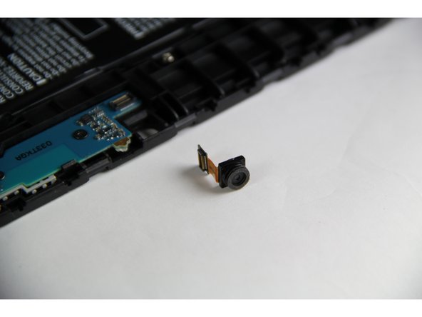

  5. LG G Pad 10.1 Rear Facing Camera Replacement, Rear Facing Camera: crwdns2935265:05crwdnd2935265:01crwdnd2935265:01crwdne2935265:0
    • Locate the back camera at the far end of the motherboard, towards the lower center of the device.
    • Separate the connection to the motherboard with the spudger by gently prying them apart.
  6. LG G Pad 10.1 Rear Facing Camera Replacement: crwdns2935265:06crwdnd2935265:01crwdnd2935265:02crwdne2935265:0 LG G Pad 10.1 Rear Facing Camera Replacement: crwdns2935265:06crwdnd2935265:02crwdnd2935265:02crwdne2935265:0
    • Pull the camera upwards to remove it from the device.
