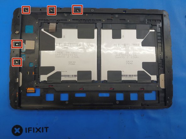

      • To remove the back panel of the device, start by attempting to fit the plastic opening tool in the crease between the screen and the back panel of the tablet.
      • Try opening picks if the case is not flexing enough, or if it is already cracked to prevent further damage.
      • You can use your hands to push against the corners of the device to attempt to make the gap larger for your plastic opening tool to fit in.
      • If you are replacing your screen because it is damaged, it may be useful to pick away at some of the glass to expose the clips in the edges of the plastic.
      • Insert the corners of your plastic opening tool into the slots that are on the very outside edge of your device to start disconnecting the panel.
      • On some models, there is a vertical strip of adhesive between the battery and the back cover on the left side of the Verizon logo. Be careful not to damage the battery when separating the adhesive!

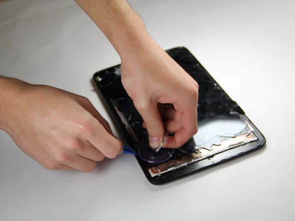

      • Use a hair dryer or heat gun to soften the adhesive holding the display assembly to the frame.
      • Heat one side of the device, then insert opening picks between the digitizer and the frame to separate the adhesive.
      • Heat one side of the device at a time to ensure that the adhesive stays soft.
      • If your screen is severely cracked, use a suction cup to pull the display assembly up.
      • Be careful to not bend the metal tabs in these areas.

Is there a place where one can purchase the glass for this? And can one do the glass only repair on this like you can an iPad without any uv lights and glue?
mcaddie7 - crwdns2934203:0crwdne2934203:0 crwdns2950251:0crwdne2950251:0
my lg 700 was dropped. the outer glass was cracked but i cant tell if i need the lcd screen also. the device doesn't respond to any screen commands at all, it just turns on and then the screen goes into the regular power save. does this mean i need an lcd too? or is it expected that the unit wont take any commands if the outer glass is cracked. my only comparison is an iphone 4 that was driven over with the glass completely shattered, but the apps still responded through the shattered glass. any ideas?
John Burns - crwdns2934203:0crwdne2934203:0 crwdns2950251:0crwdne2950251:0
The full LCD assembly is required, the glass is LOCA to the LCD, parts are available on ebay.
neilorr89 - crwdns2934203:0crwdne2934203:0 crwdns2950251:0crwdne2950251:0
What does it mean the glass is LOCA to the LCD? I ordered a replacement glass for mine without the LCD. My LCD seems to be fine. Is it necessary to complete this full removal or is there a way to just affix the glass to the LCD?
Mark MacLachlan - crwdns2934203:0crwdne2934203:0 crwdns2950251:0crwdne2950251:0
Mark MacLachlan - LOCA is Liquid Optically Clear Adhesive - Here is more info: https://en.wikipedia.org/wiki/Liquid_opt...
Having just done this repair, it is nearly impossible, even with a heat plate, to separate the digitizer from the LCD without scratching or damaging the LCD, and the time alone is not worth it. Buy the LCD/Digitizer as one unit.
