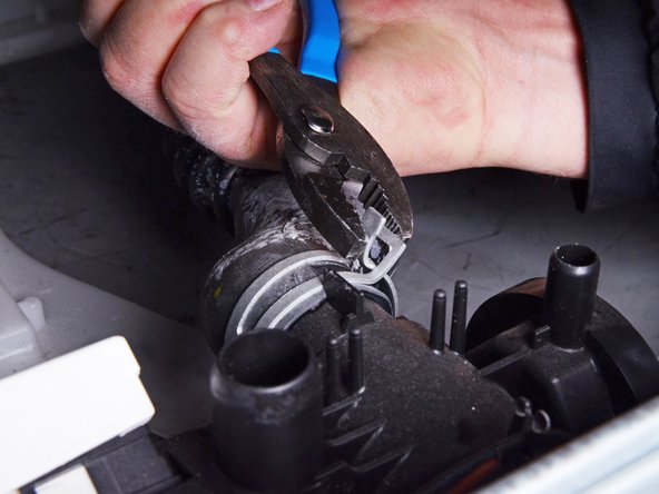

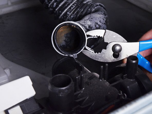

    1. LG Front Load Washing Machine Pump Hose Replacement, Disconnect the tub to pump hose: crwdns2935265:027crwdnd2935265:01crwdnd2935265:03crwdne2935265:0 LG Front Load Washing Machine Pump Hose Replacement, Disconnect the tub to pump hose: crwdns2935265:027crwdnd2935265:02crwdnd2935265:03crwdne2935265:0 LG Front Load Washing Machine Pump Hose Replacement, Disconnect the tub to pump hose: crwdns2935265:027crwdnd2935265:03crwdnd2935265:03crwdne2935265:0
      • Use slip joint pliers to pinch the tub to pump hose clamp and pull it away from the assembly.
      • Pull the hose straight off the assembly to disconnect it.

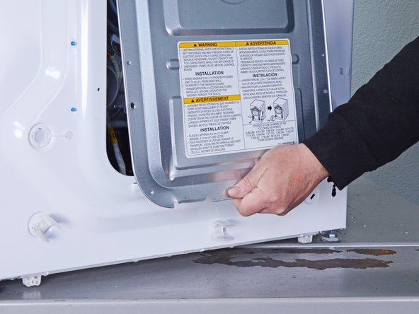

    1. LG Front Load Washing Machine Pump Hose Replacement, Unfasten the rear panel: crwdns2935265:028crwdnd2935265:01crwdnd2935265:03crwdne2935265:0 LG Front Load Washing Machine Pump Hose Replacement, Unfasten the rear panel: crwdns2935265:028crwdnd2935265:02crwdnd2935265:03crwdne2935265:0 LG Front Load Washing Machine Pump Hose Replacement, Unfasten the rear panel: crwdns2935265:028crwdnd2935265:03crwdnd2935265:03crwdne2935265:0
      • Remove the screw(s) securing the rear panel.
    2. LG Front Load Washing Machine Pump Hose Replacement, Remove the rear panel: crwdns2935265:029crwdnd2935265:01crwdnd2935265:03crwdne2935265:0 LG Front Load Washing Machine Pump Hose Replacement, Remove the rear panel: crwdns2935265:029crwdnd2935265:02crwdnd2935265:03crwdne2935265:0 LG Front Load Washing Machine Pump Hose Replacement, Remove the rear panel: crwdns2935265:029crwdnd2935265:03crwdnd2935265:03crwdne2935265:0
      • Unclip the rear panel from the chassis.
    3. LG Front Load Washing Machine Pump Hose Replacement: crwdns2935265:030crwdnd2935265:01crwdnd2935265:01crwdne2935265:0
      • Remove the rear panel.

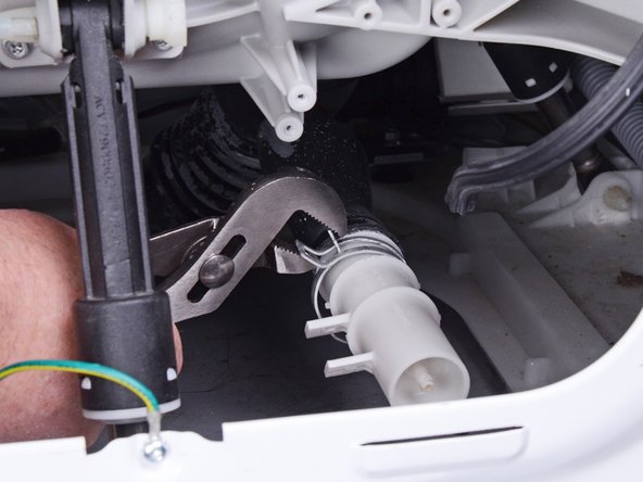

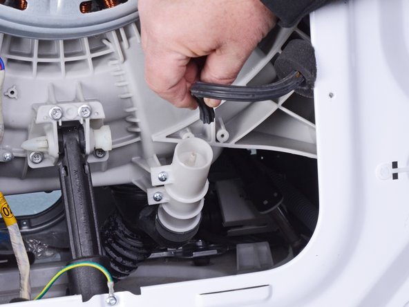

    1. LG Front Load Washing Machine Pump Hose Replacement, Disconnect the air dome: crwdns2935265:031crwdnd2935265:01crwdnd2935265:02crwdne2935265:0 LG Front Load Washing Machine Pump Hose Replacement, Disconnect the air dome: crwdns2935265:031crwdnd2935265:02crwdnd2935265:02crwdne2935265:0
      • Pull the hose straight off the air dome hose to disconnect it.
    2. LG Front Load Washing Machine Pump Hose Replacement, Unfasten the air dome: crwdns2935265:032crwdnd2935265:01crwdnd2935265:01crwdne2935265:0
      • Remove the screw(s) securing the air dome.
    3. LG Front Load Washing Machine Pump Hose Replacement: crwdns2935265:033crwdnd2935265:01crwdnd2935265:03crwdne2935265:0 LG Front Load Washing Machine Pump Hose Replacement: crwdns2935265:033crwdnd2935265:02crwdnd2935265:03crwdne2935265:0 LG Front Load Washing Machine Pump Hose Replacement: crwdns2935265:033crwdnd2935265:03crwdnd2935265:03crwdne2935265:0
      • Use slip joint pliers to pinch the air dome hose clamp and pull it over the dome itself.
    4. LG Front Load Washing Machine Pump Hose Replacement, Remove the air dome: crwdns2935265:034crwdnd2935265:01crwdnd2935265:02crwdne2935265:0 LG Front Load Washing Machine Pump Hose Replacement, Remove the air dome: crwdns2935265:034crwdnd2935265:02crwdnd2935265:02crwdne2935265:0
      • Pull the air dome straight off its hose to remove it.

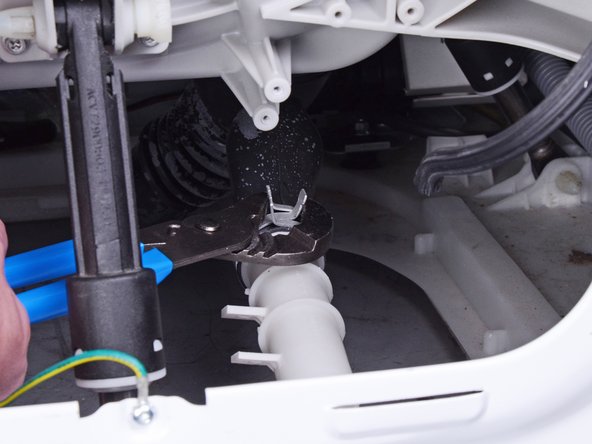

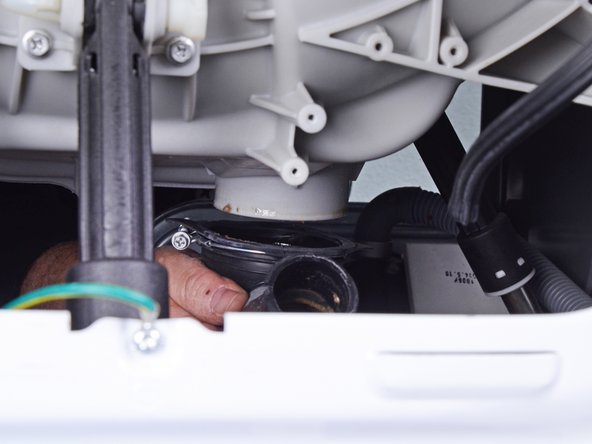

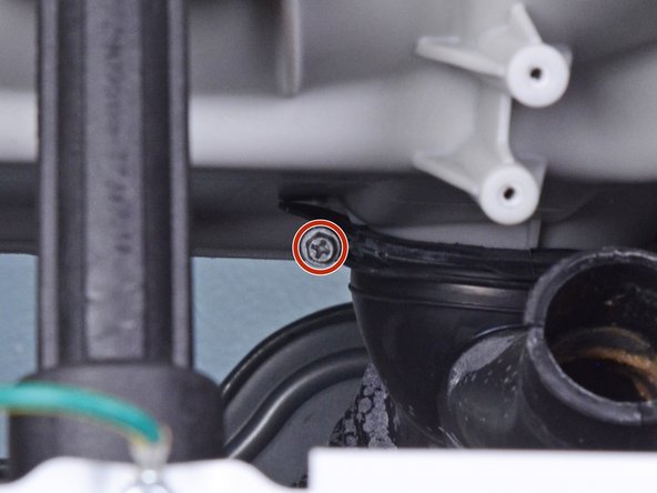

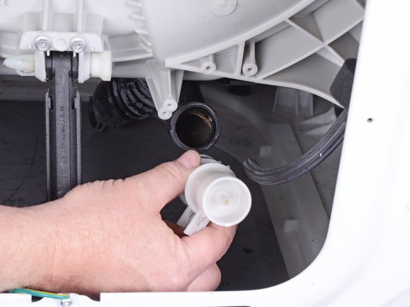

    1. LG Front Load Washing Machine Pump Hose Replacement, Loosen the pump hose: crwdns2935265:035crwdnd2935265:01crwdnd2935265:02crwdne2935265:0 LG Front Load Washing Machine Pump Hose Replacement, Loosen the pump hose: crwdns2935265:035crwdnd2935265:02crwdnd2935265:02crwdne2935265:0
      • Use a Phillips driver to loosen the pump hose from the drum enough to disconnect it.
    2. LG Front Load Washing Machine Pump Hose Replacement, Disconnect the pump hose: crwdns2935265:036crwdnd2935265:01crwdnd2935265:02crwdne2935265:0 LG Front Load Washing Machine Pump Hose Replacement, Disconnect the pump hose: crwdns2935265:036crwdnd2935265:02crwdnd2935265:02crwdne2935265:0
      • Pull the pump hose straight off the drum to disconnect it.
    3. LG Front Load Washing Machine Pump Hose Replacement, Remove the pump hose: crwdns2935265:037crwdnd2935265:01crwdnd2935265:01crwdne2935265:0
      • Remove the pump hose.
      • During reassembly, use liquid laundry detergent to lubricate the hose around its tub connection.
