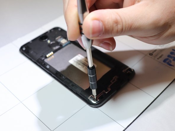

    1. LG Fortune Speaker Replacement, Speaker: crwdns2935265:03crwdnd2935265:01crwdnd2935265:02crwdne2935265:0 LG Fortune Speaker Replacement, Speaker: crwdns2935265:03crwdnd2935265:02crwdnd2935265:02crwdne2935265:0
      • Use your PH000 screwdriver to remove the ten 1.4mm x 4mm screws.

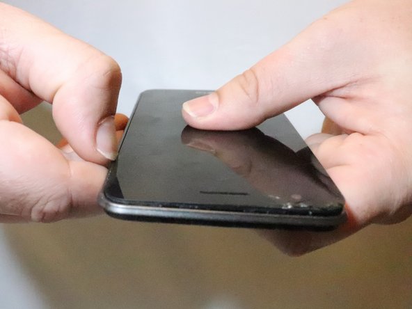

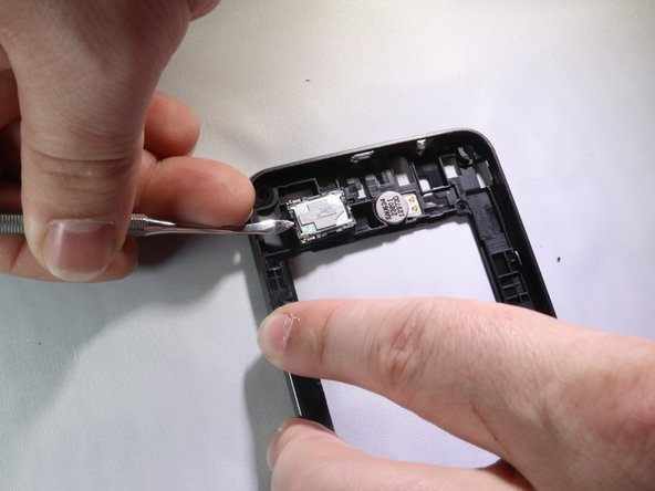

    3. LG Fortune Speaker Replacement: crwdns2935265:05crwdnd2935265:01crwdnd2935265:02crwdne2935265:0 LG Fortune Speaker Replacement: crwdns2935265:05crwdnd2935265:02crwdnd2935265:02crwdne2935265:0
      • Use either a spudger or your finger to separate the back of the device from the screen.
      • Using a metal spudger as shown in the photos has the potential to damage your device.
      • You will wedge your item on the upper right hand corner of the device to separate them. The speaker will be on the side of the device not connected to the screen.

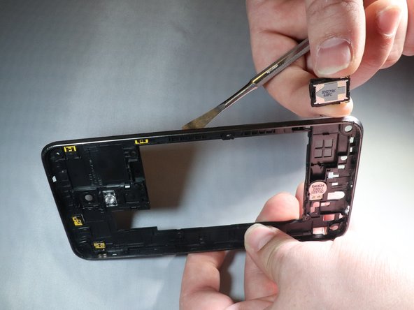

    4. LG Fortune Speaker Replacement: crwdns2935265:06crwdnd2935265:01crwdnd2935265:03crwdne2935265:0 LG Fortune Speaker Replacement: crwdns2935265:06crwdnd2935265:02crwdnd2935265:03crwdne2935265:0 LG Fortune Speaker Replacement: crwdns2935265:06crwdnd2935265:03crwdnd2935265:03crwdne2935265:0
      • Using the metal spudger lift up and remove the speaker along with the magnetic tape it comes with.
