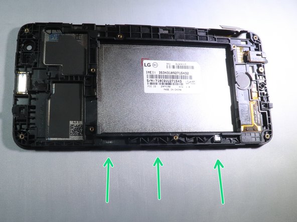

    1. LG Fortune Screen Replacement, Screen: crwdns2935265:09crwdnd2935265:01crwdnd2935265:02crwdne2935265:0 LG Fortune Screen Replacement, Screen: crwdns2935265:09crwdnd2935265:02crwdnd2935265:02crwdne2935265:0
      • You will remove the microphone from underside of the screen.
      • The microphone will be located on the bottom right side of the device
      • Once the mic is off, the screen is by itself and ready to be replaced.
