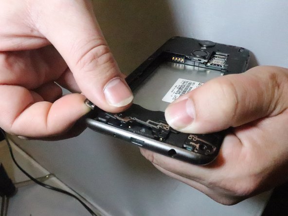

    • Using a PH000 screwdriver, remove the ten 4mm screws on the back panelling.
    • Remove the back panelling from the device with your fingers or a spudger.
    • Work slowly side to side to release this back casing and expose the motherboard.
