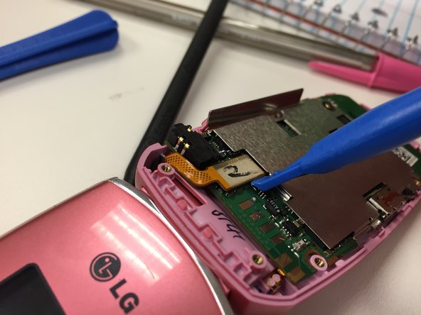

  5. LG Flare Keyboard Replacement: crwdns2935265:05crwdnd2935265:01crwdnd2935265:02crwdne2935265:0 LG Flare Keyboard Replacement: crwdns2935265:05crwdnd2935265:02crwdnd2935265:02crwdne2935265:0
    • Place the blue wedge between the orange connecting strip (located at the top right of the back of the phone) and the green circuit board.
    • Carefully pry the connecting strip upward to remove it. The connecting strip and circuit board are fragile, so be sure not to apply too much pressure.

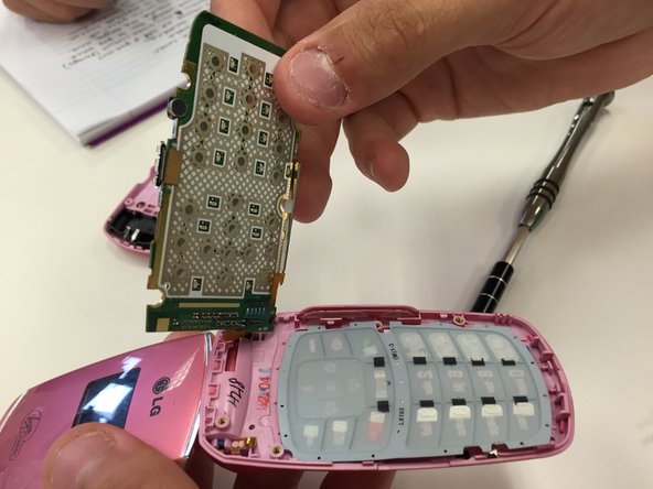

  6. LG Flare Keyboard Replacement: crwdns2935265:06crwdnd2935265:01crwdnd2935265:02crwdne2935265:0 LG Flare Keyboard Replacement: crwdns2935265:06crwdnd2935265:02crwdnd2935265:02crwdne2935265:0
    • Use blue wedge to separate the two pink tabs above the green circuit board from front body of phone. The tabs are circled in yellow on the photo.
    • Once the tabs are separated, use the blue prying tool or your fingers to remove the circuit.
  7. LG Flare Keyboard Replacement: crwdns2935265:07crwdnd2935265:01crwdnd2935265:01crwdne2935265:0
    • Remove gel keyboard using your fingers or the blue wedge.
    • To reassemble the device, follow the instructions in reverse order.
