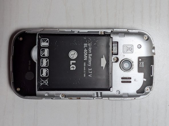

  2. LG Extravert 2 Teardown, Remove the battery: crwdns2935265:02crwdnd2935265:01crwdnd2935265:02crwdne2935265:0 LG Extravert 2 Teardown, Remove the battery: crwdns2935265:02crwdnd2935265:02crwdnd2935265:02crwdne2935265:0
    • To remove the battery, use your opening tool or fingernail again, and place it in the indent in the plastic. Pull up and lift out the battery.
    • Please be careful with the battery! Do not bend, puncture, light it on fire, or get it wet!

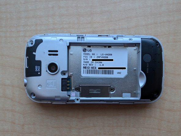

  3. LG Extravert 2 Teardown, Remove back shell screws: crwdns2935265:03crwdnd2935265:01crwdnd2935265:02crwdne2935265:0 LG Extravert 2 Teardown, Remove back shell screws: crwdns2935265:03crwdnd2935265:02crwdnd2935265:02crwdne2935265:0
    • Remove the 9 back screws with a Phillips #000 screwdriver.

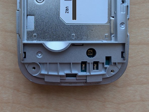

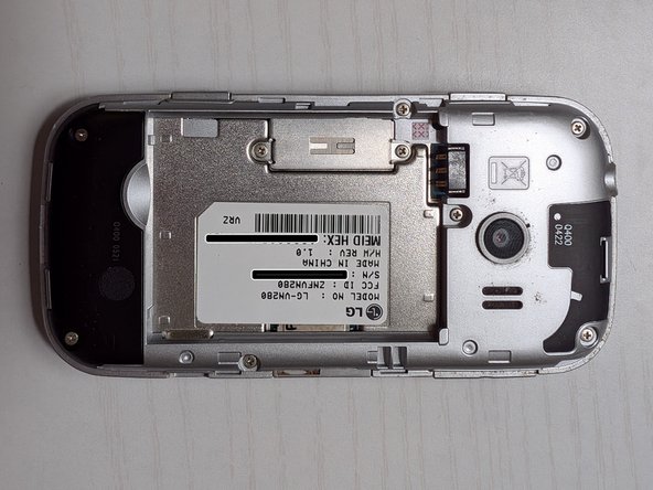

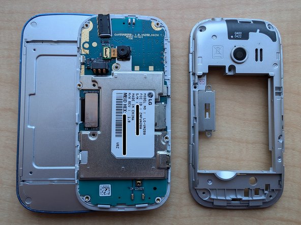

  4. LG Extravert 2 Teardown, Remove the black plate: crwdns2935265:04crwdnd2935265:01crwdnd2935265:02crwdne2935265:0 LG Extravert 2 Teardown, Remove the black plate: crwdns2935265:04crwdnd2935265:02crwdnd2935265:02crwdne2935265:0
    • Not to be confused with the back panel!
    • To remove the bottom black plate, insert a jimmy in the center, between the back panel and the black plate, and lift up to separate it partially. Then, do the same thing on the left side of the phone. Finally, do it again on the left bottom side, and the plate should pop out.

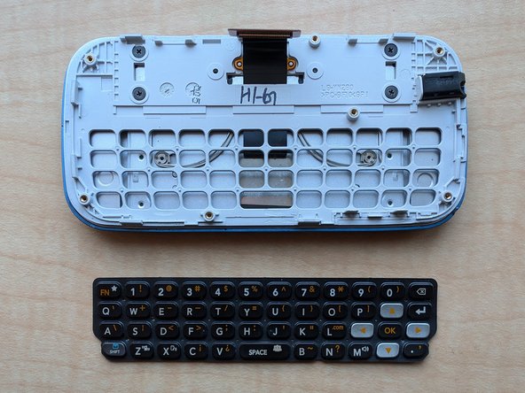

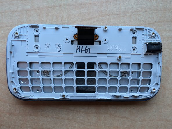

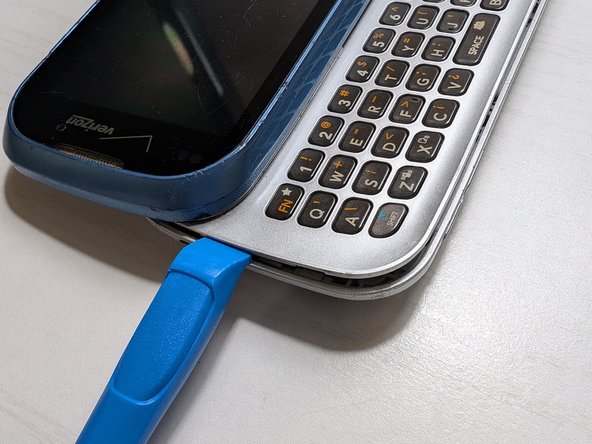

  5. LG Extravert 2 Teardown, Take off the back panel: crwdns2935265:05crwdnd2935265:01crwdnd2935265:03crwdne2935265:0 LG Extravert 2 Teardown, Take off the back panel: crwdns2935265:05crwdnd2935265:02crwdnd2935265:03crwdne2935265:0 LG Extravert 2 Teardown, Take off the back panel: crwdns2935265:05crwdnd2935265:03crwdnd2935265:03crwdne2935265:0
    • Not to be confused with the black panel!
    • To remove the plate, flip over the phone, and slide out the keyboard. Press down on the panel, outside of the keyboard, and part of it will pop out, where pressure was applied. Repeat this process around the keyboard, and the back panel will fall off.

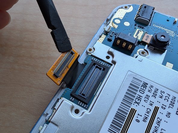

  6. LG Extravert 2 Teardown, Detatch the display ribbon cable: crwdns2935265:06crwdnd2935265:01crwdnd2935265:02crwdne2935265:0 LG Extravert 2 Teardown, Detatch the display ribbon cable: crwdns2935265:06crwdnd2935265:02crwdnd2935265:02crwdne2935265:0
    • Insert the spudger tool in between the cable connector and the motherboard, and pry up to disconnect the cable.

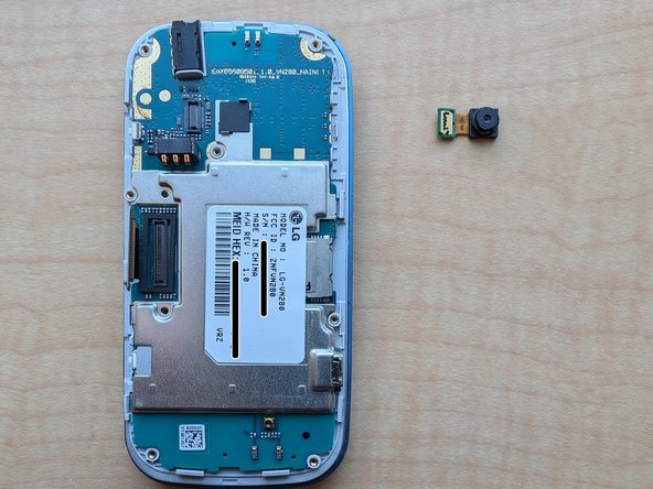

  7. LG Extravert 2 Teardown, Detatch the back camera: crwdns2935265:07crwdnd2935265:01crwdnd2935265:02crwdne2935265:0 LG Extravert 2 Teardown, Detatch the back camera: crwdns2935265:07crwdnd2935265:02crwdnd2935265:02crwdne2935265:0
    • Like the step before, use the spudger tool to pry the camera connector off of the motherboard. There should be no glue or anything holding the camera down, other than the connector.

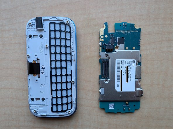

  8. LG Extravert 2 Teardown, Remove the motherboard: crwdns2935265:08crwdnd2935265:01crwdnd2935265:02crwdne2935265:0 LG Extravert 2 Teardown, Remove the motherboard: crwdns2935265:08crwdnd2935265:02crwdnd2935265:02crwdne2935265:0
    • Pry the motherboard away from the plastic shell, by inserting the spudger at the top-left of the phone (next to the headphone jack), and lift up.

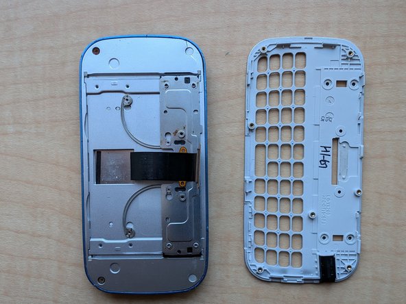

  10. LG Extravert 2 Teardown, Unscrew the sliding mechanism from the shell: crwdns2935265:010crwdnd2935265:01crwdnd2935265:02crwdne2935265:0 LG Extravert 2 Teardown, Unscrew the sliding mechanism from the shell: crwdns2935265:010crwdnd2935265:02crwdnd2935265:02crwdne2935265:0
    • Using a Phillips #000 screwdriver, unscrew the 4 screws holding the keyboard shell into the sliding mechanism.

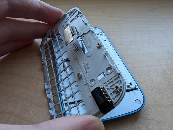

  11. LG Extravert 2 Teardown, Remove the keyboard slide-out plate: crwdns2935265:011crwdnd2935265:01crwdnd2935265:03crwdne2935265:0 LG Extravert 2 Teardown, Remove the keyboard slide-out plate: crwdns2935265:011crwdnd2935265:02crwdnd2935265:03crwdne2935265:0 LG Extravert 2 Teardown, Remove the keyboard slide-out plate: crwdns2935265:011crwdnd2935265:03crwdnd2935265:03crwdne2935265:0
    • First, use the spudger to remove the ribbon cable from the shell. There should be a little bit of glue holding it in. Once it's been lifted up, remove the plate by lifting it, and remove the ribbon cable from the hole in the plate.

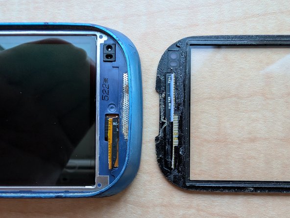

    • Please do not try to disassemble the screen assembly. There are screws, as shown, but they do not really hold in the screen's back plate. It is fused to the front plate, which I learned the hard way (I cracked it a little bit, highlighted with the red circle).
    • Do not try to remove the screen bezel either, as it is the digitizer, and has a cable connected to the inside of the assembly, which, again, you cannot get in to. I also was not careful with that and found out the hard way, as shown in the second image.
    • If you would like to replace the screen, please buy another screen assembly, and follow this guide in reverse.
