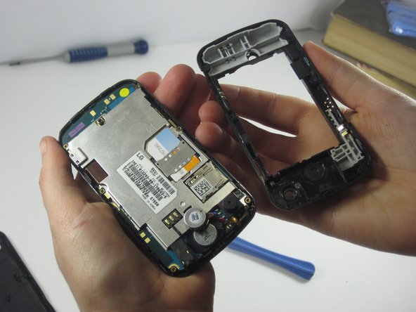

    • Remove the six screws around the outside of the phone using a Phillips #0 screwdriver.
  4. LG Encore GT550 Camera Replacement: crwdns2935265:04crwdnd2935265:01crwdnd2935265:02crwdne2935265:0 LG Encore GT550 Camera Replacement: crwdns2935265:04crwdnd2935265:02crwdnd2935265:02crwdne2935265:0
    • Hook the iFixit opening tool onto the side of the front panel.
    • Pry away from the phone with the opening tool to remove the front panel.
  5. LG Encore GT550 Camera Replacement: crwdns2935265:05crwdnd2935265:01crwdnd2935265:02crwdne2935265:0 LG Encore GT550 Camera Replacement: crwdns2935265:05crwdnd2935265:02crwdnd2935265:02crwdne2935265:0
    • Insert the small end of the opening tool between the motherboard and the side of the phone.
    • Use leverage to remove the motherboard.
