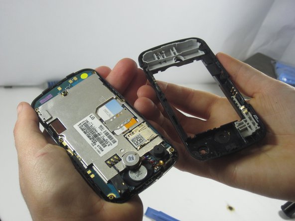

  4. LG Encore GT550 Audio Jack Replacement: crwdns2935265:04crwdnd2935265:01crwdnd2935265:02crwdne2935265:0 LG Encore GT550 Audio Jack Replacement: crwdns2935265:04crwdnd2935265:02crwdnd2935265:02crwdne2935265:0
    • Place the opening tool in the seam of the device and pry around the perimeter to separate the top case from the bottom case.
  5. LG Encore GT550 Audio Jack Replacement: crwdns2935265:05crwdnd2935265:01crwdnd2935265:02crwdne2935265:0 LG Encore GT550 Audio Jack Replacement: crwdns2935265:05crwdnd2935265:02crwdnd2935265:02crwdne2935265:0
    • Place the opening tool on the top on the device between the phone casing and motherboard.
    • Separate the screen and the motherboard.
  6. LG Encore GT550 Audio Jack Replacement: crwdns2935265:06crwdnd2935265:01crwdnd2935265:01crwdne2935265:0
    • Push the audio jack out and replace it.
