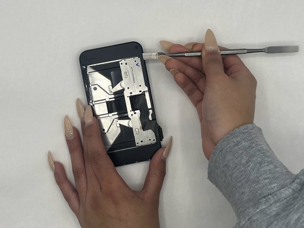

    1. LG Enact Screen Replacement, Screen: crwdns2935265:014crwdnd2935265:01crwdnd2935265:01crwdne2935265:0
      • Remove the four 1.2 mm screws from the corners using a Phillips #00 screwdriver.
    2. LG Enact Screen Replacement: crwdns2935265:015crwdnd2935265:01crwdnd2935265:02crwdne2935265:0 LG Enact Screen Replacement: crwdns2935265:015crwdnd2935265:02crwdnd2935265:02crwdne2935265:0
      • Gently pry the screen open with a nylon spudger, making sure you’re not damaging the LCD or the plastic.
    3. LG Enact Screen Replacement: crwdns2935265:016crwdnd2935265:01crwdnd2935265:02crwdne2935265:0 LG Enact Screen Replacement: crwdns2935265:016crwdnd2935265:02crwdnd2935265:02crwdne2935265:0
      • Detach the two connectors from the screen and pop the screen open using a spudger.

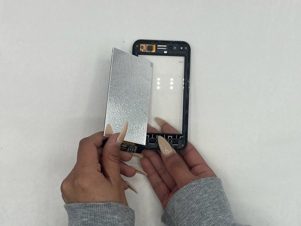

    4. LG Enact Screen Replacement: crwdns2935265:017crwdnd2935265:01crwdnd2935265:01crwdne2935265:0
      • Disconnect the touch button sensors using a spudger.
    5. LG Enact Screen Replacement: crwdns2935265:018crwdnd2935265:01crwdnd2935265:01crwdne2935265:0
      • Gently disconnect and remove the LCD using a spudger.
