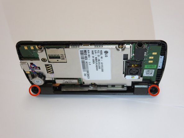

    • Open the phone at a 90 degree angle. This needs to be done in order to reach the screws.
    • Locate the two 1.5mm #000 Phillips screws on the outside of each hinge.
    • Remove the two 1.5mm #000 Phillips screws with a Phillips #000 screwdriver.

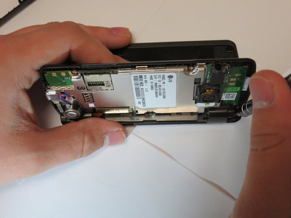

  8. LG EnV Touch VX11000 Screen Assembly Replacement: crwdns2935265:08crwdnd2935265:01crwdnd2935265:02crwdne2935265:0 LG EnV Touch VX11000 Screen Assembly Replacement: crwdns2935265:08crwdnd2935265:02crwdnd2935265:02crwdne2935265:0
    • Pry off the two screw covers on the inside screen, using a spudger or your fingernail.
    • Remove the two 1.5mm #000 Phillips screws that were under the screw covers using the Phillips #000 screwdriver.

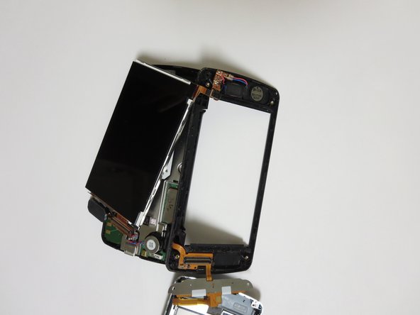

  9. LG EnV Touch VX11000 Screen Assembly Replacement: crwdns2935265:09crwdnd2935265:01crwdnd2935265:02crwdne2935265:0 LG EnV Touch VX11000 Screen Assembly Replacement: crwdns2935265:09crwdnd2935265:02crwdnd2935265:02crwdne2935265:0
    • Pry off the front frame using your fingernail.
    • The frame should still be connected to the rest of the phone by the orange tab.

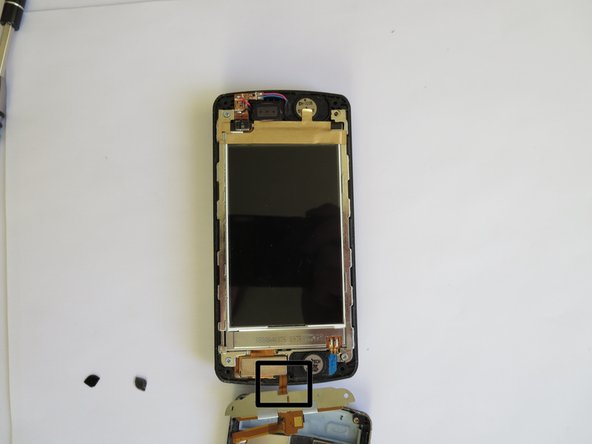

  10. LG EnV Touch VX11000 Screen Assembly Replacement: crwdns2935265:010crwdnd2935265:01crwdnd2935265:01crwdne2935265:0
    • Remove the four 1.5mm #000 Phillips screws at each of the corners of the phone, using the Phillips #000 screwdriver.

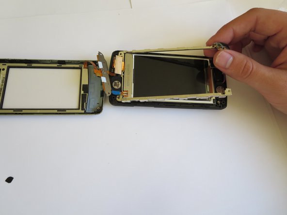

  11. LG EnV Touch VX11000 Screen Assembly Replacement: crwdns2935265:011crwdnd2935265:01crwdnd2935265:03crwdne2935265:0 LG EnV Touch VX11000 Screen Assembly Replacement: crwdns2935265:011crwdnd2935265:02crwdnd2935265:03crwdne2935265:0 LG EnV Touch VX11000 Screen Assembly Replacement: crwdns2935265:011crwdnd2935265:03crwdnd2935265:03crwdne2935265:0
    • Peel off the gold tape.
    • Gently pry up the metal frame with your fingers so that the screen can be removed.
  12. LG EnV Touch VX11000 Screen Assembly Replacement: crwdns2935265:012crwdnd2935265:01crwdnd2935265:02crwdne2935265:0 LG EnV Touch VX11000 Screen Assembly Replacement: crwdns2935265:012crwdnd2935265:02crwdnd2935265:02crwdne2935265:0
    • Unplug the connector from the screen.
