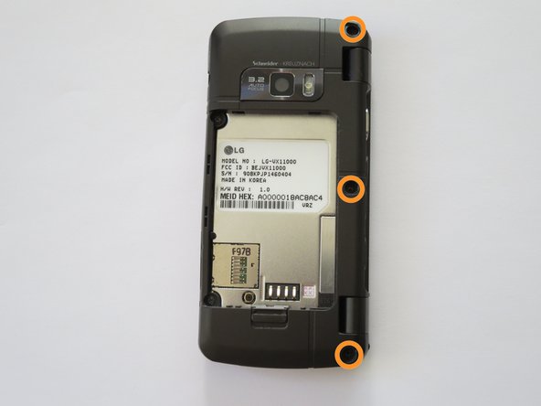

  4. LG EnV Touch VX11000 Motherboard Replacement, Volume and Camera Buttons: crwdns2935265:04crwdnd2935265:01crwdnd2935265:02crwdne2935265:0 LG EnV Touch VX11000 Motherboard Replacement, Volume and Camera Buttons: crwdns2935265:04crwdnd2935265:02crwdnd2935265:02crwdne2935265:0
    • Locate the three screw covers on the back of the phone. Using your fingernail (or a spudger, pry off screw covers.
    • Using a Phillips #000 Screwdriver, remove the 1.5mm #000 Phillips screws that were under the screw covers.
  5. LG EnV Touch VX11000 Motherboard Replacement: crwdns2935265:05crwdnd2935265:01crwdnd2935265:01crwdne2935265:0
    • Locate the two inner 1.5mm #000 Phillips screws and remove them using a Phillips #000 screwdriver.

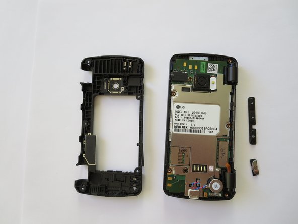

  6. LG EnV Touch VX11000 Motherboard Replacement: crwdns2935265:06crwdnd2935265:01crwdnd2935265:02crwdne2935265:0 LG EnV Touch VX11000 Motherboard Replacement: crwdns2935265:06crwdnd2935265:02crwdnd2935265:02crwdne2935265:0
    • Use a plastic opening tool or your fingernail to pry off the back case.
    • The camera and volume keys will fall off.

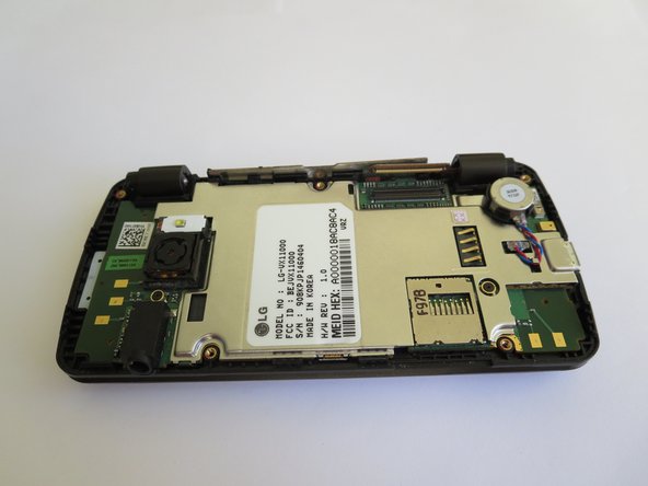

  7. LG EnV Touch VX11000 Motherboard Replacement, Motherboard: crwdns2935265:07crwdnd2935265:01crwdnd2935265:02crwdne2935265:0 LG EnV Touch VX11000 Motherboard Replacement, Motherboard: crwdns2935265:07crwdnd2935265:02crwdnd2935265:02crwdne2935265:0
    • Use your fingers to pull up on the tab in order to unplug it.

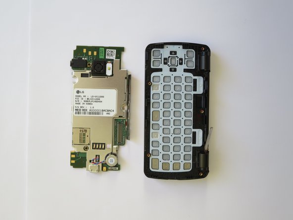

  8. LG EnV Touch VX11000 Motherboard Replacement: crwdns2935265:08crwdnd2935265:01crwdnd2935265:02crwdne2935265:0 LG EnV Touch VX11000 Motherboard Replacement: crwdns2935265:08crwdnd2935265:02crwdnd2935265:02crwdne2935265:0
    • Using both of your hands, gently pry out the motherboard by pulling up on both ends.
