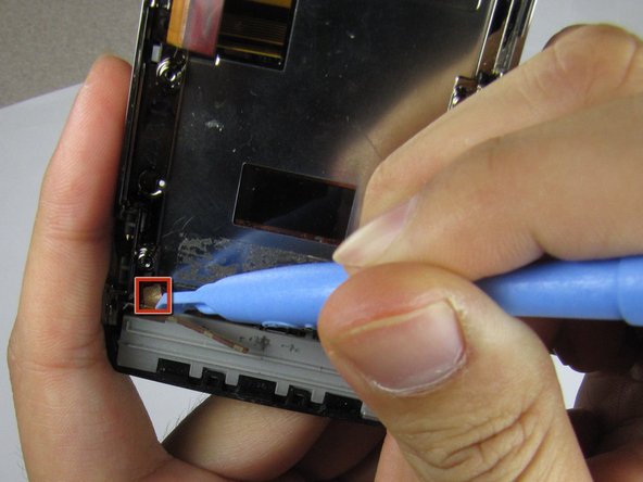

      • Undo the clips that attach the black plastic strip to the frame of the phone.
      • Pry the plastic strip away from the phone, using an opening tool, until it detaches.

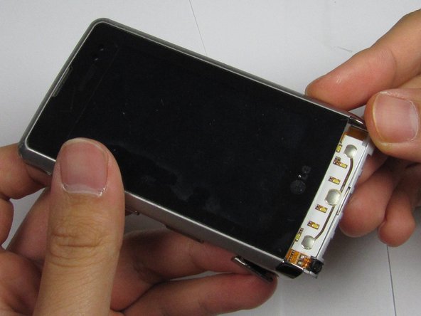

    4. LG Dare Screen Replacement: crwdns2935265:013crwdnd2935265:01crwdnd2935265:02crwdne2935265:0 LG Dare Screen Replacement: crwdns2935265:013crwdnd2935265:02crwdnd2935265:02crwdne2935265:0

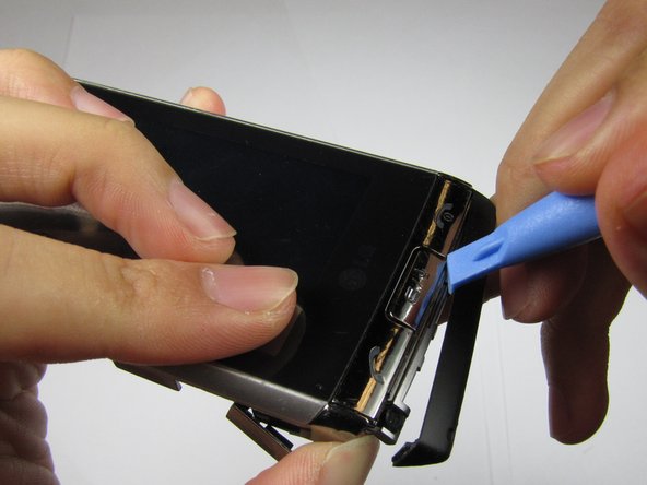

      • Pry the button panel from the device, starting where the screen and panel connect, until the panel detaches.

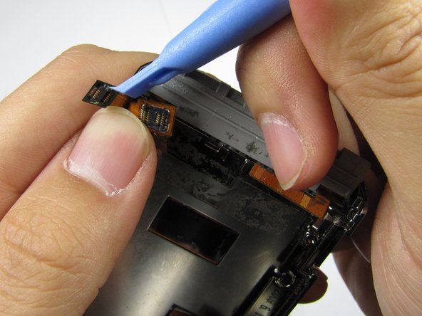

      • Rotate the phone upside down with the back facing you.
      • Using your finger to hold the bottom connector in place, use the opening tool to remove the top connector.

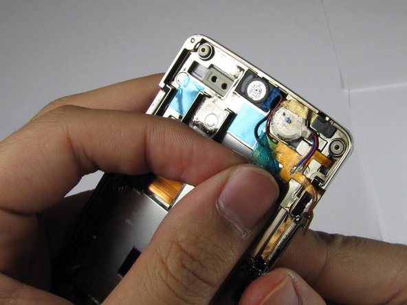

    6. LG Dare Screen Replacement: crwdns2935265:015crwdnd2935265:01crwdnd2935265:03crwdne2935265:0 LG Dare Screen Replacement: crwdns2935265:015crwdnd2935265:02crwdnd2935265:03crwdne2935265:0 LG Dare Screen Replacement: crwdns2935265:015crwdnd2935265:03crwdnd2935265:03crwdne2935265:0

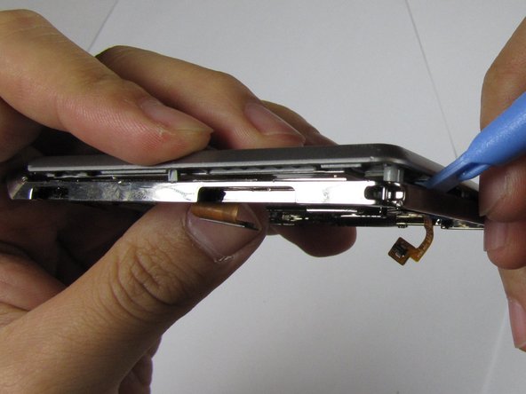

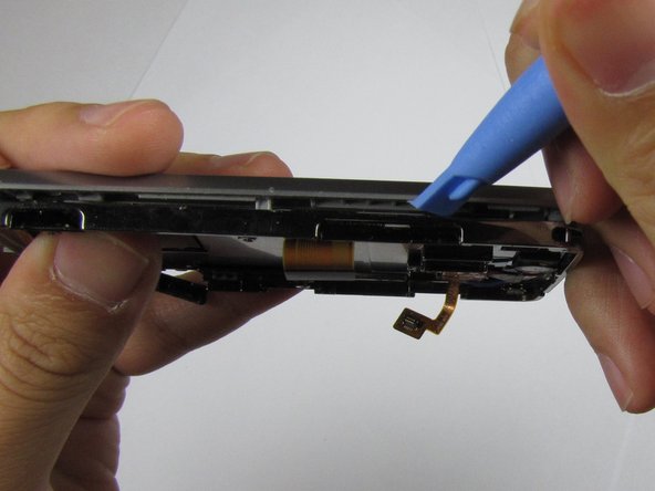

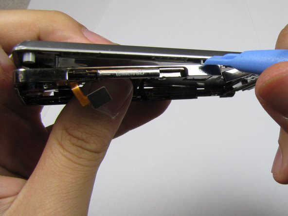

      • Using the opening tool, pry the frame from the device, starting at the open edges at the bottom of the device, and working your way around.
      • Do not detach the frame yet.

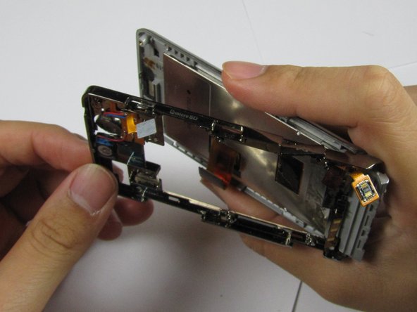

    7. LG Dare Screen Replacement: crwdns2935265:016crwdnd2935265:01crwdnd2935265:03crwdne2935265:0 LG Dare Screen Replacement: crwdns2935265:016crwdnd2935265:02crwdnd2935265:03crwdne2935265:0 LG Dare Screen Replacement: crwdns2935265:016crwdnd2935265:03crwdnd2935265:03crwdne2935265:0
      • Gently separate the top of the frame from the back of the device, without completely detaching at the bottom, as shown in the third picture.

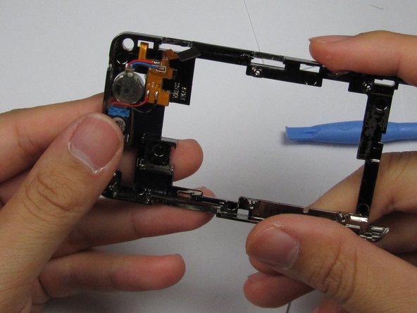

    8. LG Dare Screen Replacement: crwdns2935265:017crwdnd2935265:01crwdnd2935265:02crwdne2935265:0 LG Dare Screen Replacement: crwdns2935265:017crwdnd2935265:02crwdnd2935265:02crwdne2935265:0
      • Remove both connectors from the frame. Fold back the L-shaped connector and slide the second connector through the hole in the metal frame.
      • Remove the frame from the plastic panel.

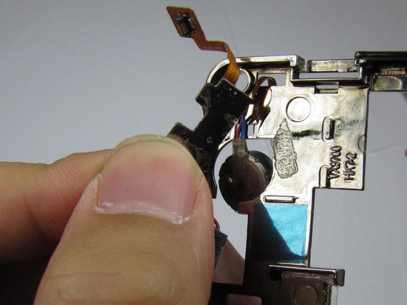

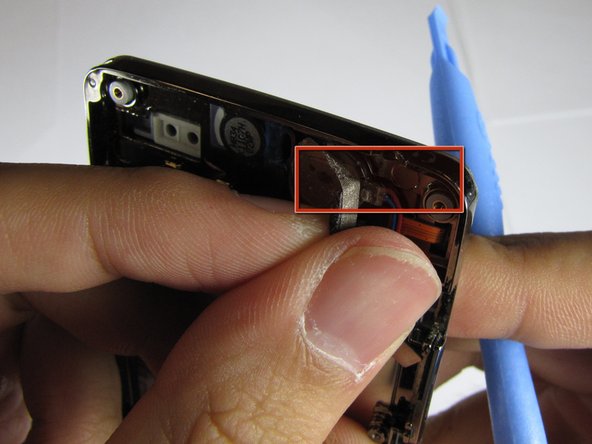

    9. LG Dare Screen Replacement: crwdns2935265:018crwdnd2935265:01crwdnd2935265:02crwdne2935265:0 LG Dare Screen Replacement: crwdns2935265:018crwdnd2935265:02crwdnd2935265:02crwdne2935265:0
      • Using the opening tool, pry the orange connector pad that is securing the earpiece to the frame, away from the device, until it detaches.
      • It may be necessary to apply more force to remove the pad because it is taped to the frame.

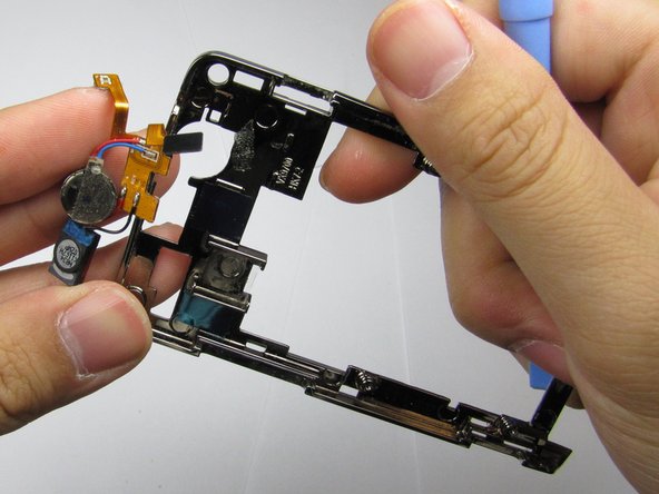

    10. LG Dare Screen Replacement: crwdns2935265:019crwdnd2935265:01crwdnd2935265:02crwdne2935265:0 LG Dare Screen Replacement: crwdns2935265:019crwdnd2935265:02crwdnd2935265:02crwdne2935265:0
      • Pry the rest of the orange connector pad --on the opposite side of the device-- away from the frame, and carefully remove the entire earpiece.

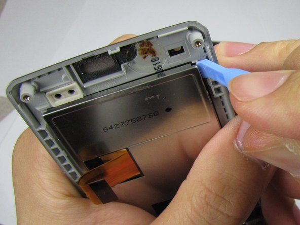

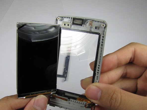

    1. LG Dare Screen Replacement, Screen: crwdns2935265:020crwdnd2935265:01crwdnd2935265:02crwdne2935265:0 LG Dare Screen Replacement, Screen: crwdns2935265:020crwdnd2935265:02crwdnd2935265:02crwdne2935265:0
      • Lift all four corners of the screen.
      • Being too aggressive could damage the screen.
    2. LG Dare Screen Replacement: crwdns2935265:021crwdnd2935265:01crwdnd2935265:02crwdne2935265:0 LG Dare Screen Replacement: crwdns2935265:021crwdnd2935265:02crwdnd2935265:02crwdne2935265:0
      • Remove the screen from the digitizer.
