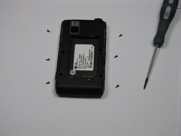

    1. LG Dare Logic Board Replacement, Logic Board: crwdns2935265:03crwdnd2935265:01crwdnd2935265:02crwdne2935265:0 LG Dare Logic Board Replacement, Logic Board: crwdns2935265:03crwdnd2935265:02crwdnd2935265:02crwdne2935265:0
      • Use the #00 screwdriver to remove the six 4mm phillips screws located around the edges of the phone.

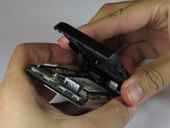

    2. LG Dare Logic Board Replacement: crwdns2935265:04crwdnd2935265:01crwdnd2935265:03crwdne2935265:0 LG Dare Logic Board Replacement: crwdns2935265:04crwdnd2935265:02crwdnd2935265:03crwdne2935265:0 LG Dare Logic Board Replacement: crwdns2935265:04crwdnd2935265:03crwdnd2935265:03crwdne2935265:0

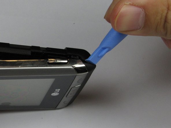

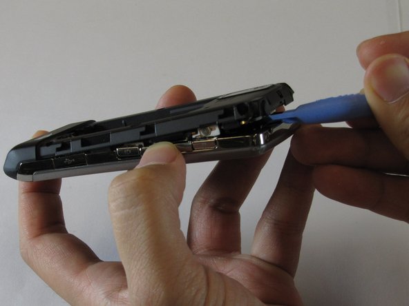

      • Lift the back plastic cover off by moving the opening tool around the edges of the phone.
      • Wedging the opening tool in several places on the bottom of the phone will help release small tabs that hold the back to the front frame.
      • The side buttons may fall out when removing the back plastic.

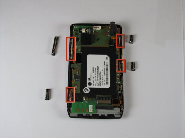

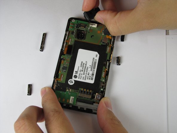

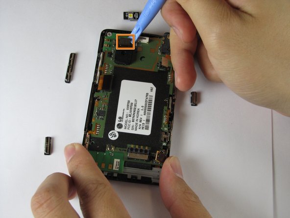

    3. LG Dare Logic Board Replacement: crwdns2935265:05crwdnd2935265:01crwdnd2935265:03crwdne2935265:0 LG Dare Logic Board Replacement: crwdns2935265:05crwdnd2935265:02crwdnd2935265:03crwdne2935265:0 LG Dare Logic Board Replacement: crwdns2935265:05crwdnd2935265:03crwdnd2935265:03crwdne2935265:0
      • Pull off the back plastic panel.
      • Remove the buttons from the edge of the frame. The buttons are [lock], [volume control], [speaker], and [camera].
    4. LG Dare Logic Board Replacement: crwdns2935265:06crwdnd2935265:01crwdnd2935265:01crwdne2935265:0
      • Disconnect the three ribbon connectors from the motherboard.
    5. LG Dare Logic Board Replacement: crwdns2935265:07crwdnd2935265:01crwdnd2935265:03crwdne2935265:0 LG Dare Logic Board Replacement: crwdns2935265:07crwdnd2935265:02crwdnd2935265:03crwdne2935265:0 LG Dare Logic Board Replacement: crwdns2935265:07crwdnd2935265:03crwdnd2935265:03crwdne2935265:0
      • Remove the LED.
      • Remove the camera connector.
      • Remove the camera sensor from the logic board. Squeeze the sides of the camera sensor firmly and pull straight up.

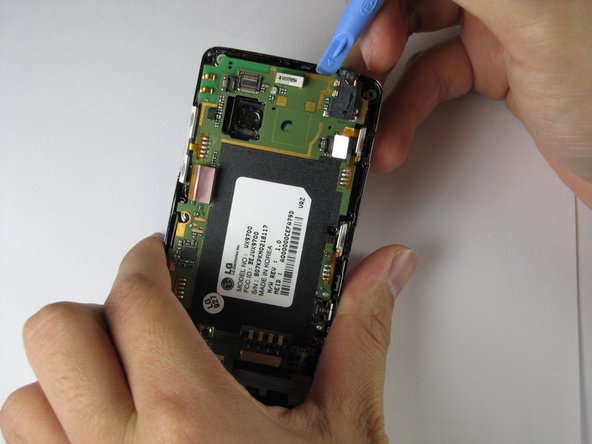

    7. LG Dare Logic Board Replacement: crwdns2935265:09crwdnd2935265:01crwdnd2935265:03crwdne2935265:0 LG Dare Logic Board Replacement: crwdns2935265:09crwdnd2935265:02crwdnd2935265:03crwdne2935265:0 LG Dare Logic Board Replacement: crwdns2935265:09crwdnd2935265:03crwdnd2935265:03crwdne2935265:0

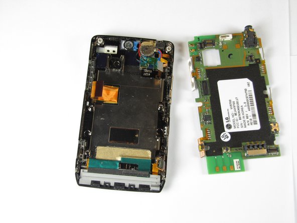

      • Use the opening tool to lift up the green logic board in all areas and remove it.
      • The logic board may require some force to remove because it is taped to the plastic frame.
      • When removing the logic board, be careful not to tear any of the ribbon cables or side buttons.
