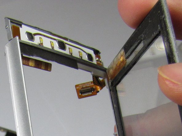

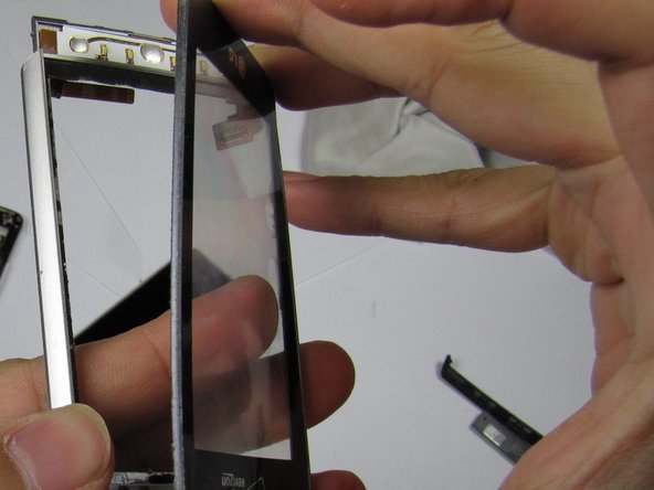

    1. LG Dare Digitizer Replacement, Digitizer: crwdns2935265:022crwdnd2935265:01crwdnd2935265:03crwdne2935265:0 LG Dare Digitizer Replacement, Digitizer: crwdns2935265:022crwdnd2935265:02crwdnd2935265:03crwdne2935265:0 LG Dare Digitizer Replacement, Digitizer: crwdns2935265:022crwdnd2935265:03crwdnd2935265:03crwdne2935265:0
      • Using the opening tool, carefully pry the digitizer (the black-rimmed piece) away from the silver frame.
      • Remove the digitizer carefully without breaking the connector.
      • Be careful when removing the digitizer because it is glued to the front panel. It may be necessary to apply more force or use a blow dryer to loosen the glue.
    2. LG Dare Digitizer Replacement: crwdns2935265:023crwdnd2935265:01crwdnd2935265:01crwdne2935265:0
      • Carefully remove the digitizer connector from the plastic frame. There is a slot that the connector slides through.
