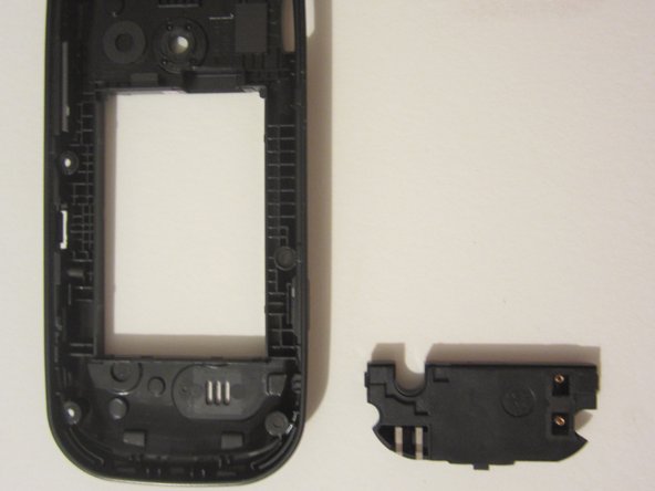

    • Insert the plastic opener into the slot at the top of the device.
    • Apply gentle pressure with the plastic tool to pop the back case off.
  2. LG Cosmos 2 Speaker Replacement: crwdns2935265:02crwdnd2935265:01crwdnd2935265:03crwdne2935265:0 LG Cosmos 2 Speaker Replacement: crwdns2935265:02crwdnd2935265:02crwdnd2935265:03crwdne2935265:0 LG Cosmos 2 Speaker Replacement: crwdns2935265:02crwdnd2935265:03crwdnd2935265:03crwdne2935265:0
    • Use the plastic opener to lift, and remove, the device battery.
  3. LG Cosmos 2 Speaker Replacement, Rear Case: crwdns2935265:03crwdnd2935265:01crwdnd2935265:01crwdne2935265:0
    • Use a screwdriver and corresponding bit to remove the six 2mm screws that are located along the edge of the rear case. Set the screws aside.
  4. LG Cosmos 2 Speaker Replacement: crwdns2935265:04crwdnd2935265:01crwdnd2935265:03crwdne2935265:0 LG Cosmos 2 Speaker Replacement: crwdns2935265:04crwdnd2935265:02crwdnd2935265:03crwdne2935265:0 LG Cosmos 2 Speaker Replacement: crwdns2935265:04crwdnd2935265:03crwdnd2935265:03crwdne2935265:0
    • Use the plastic opener to pry the rear case loose.
    • This can be difficult. You will need to pry around the entire edge of the rear case, not just in one place.
  5. LG Cosmos 2 Speaker Replacement, Speaker: crwdns2935265:05crwdnd2935265:01crwdnd2935265:02crwdne2935265:0 LG Cosmos 2 Speaker Replacement, Speaker: crwdns2935265:05crwdnd2935265:02crwdnd2935265:02crwdne2935265:0
    • Use the TOOL to pry open the plastic piece located at the bottom of the rear case. This piece contains the speaker.
