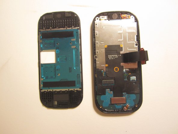

  13. LG Cosmos 2 Option Buttons Replacement: crwdns2935265:013crwdnd2935265:01crwdnd2935265:02crwdne2935265:0 LG Cosmos 2 Option Buttons Replacement: crwdns2935265:013crwdnd2935265:02crwdnd2935265:02crwdne2935265:0
    • Use the plastic opener to pry open the front of the phone.
    • Slip the ribbon cable through the slit to fully separate the two pieces.

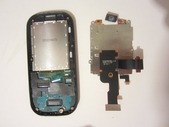

    • Use a screwdriver and corresponding bit to remove the two 1mm screws. Set the screws aside.

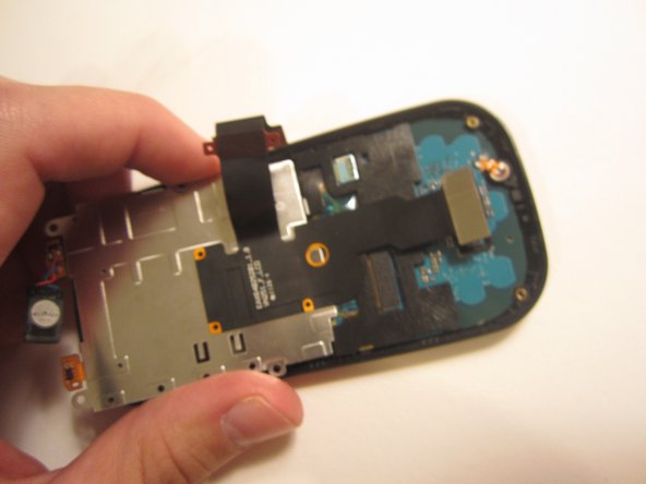

  15. LG Cosmos 2 Option Buttons Replacement: crwdns2935265:015crwdnd2935265:01crwdnd2935265:01crwdne2935265:0
    • Detach the ribbon cable with the plastic opener.
  16. LG Cosmos 2 Option Buttons Replacement: crwdns2935265:016crwdnd2935265:01crwdnd2935265:03crwdne2935265:0 LG Cosmos 2 Option Buttons Replacement: crwdns2935265:016crwdnd2935265:02crwdnd2935265:03crwdne2935265:0 LG Cosmos 2 Option Buttons Replacement: crwdns2935265:016crwdnd2935265:03crwdnd2935265:03crwdne2935265:0
    • Use the spudger to pry the metal piece loose.
    • Remove the metal piece along with the two ribbon cables.

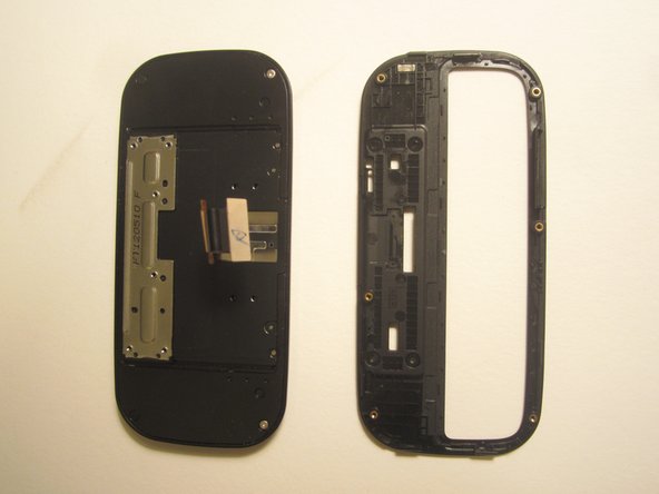

  17. LG Cosmos 2 Option Buttons Replacement: crwdns2935265:017crwdnd2935265:01crwdnd2935265:01crwdne2935265:0
    • Flip the front of the phone over and the old option buttons will fall out.
    • Insert new option buttons.
