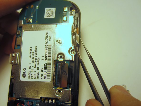

    1. LG Cosmos 2 Motherboard Replacement, Motherboard: crwdns2935265:05crwdnd2935265:01crwdnd2935265:01crwdne2935265:0
      • Use a screwdriver and corresponding bit to remove the two 3mm screws that attach the motherboard to the front case. Set the screws aside
    2. LG Cosmos 2 Motherboard Replacement: crwdns2935265:06crwdnd2935265:01crwdnd2935265:01crwdne2935265:0

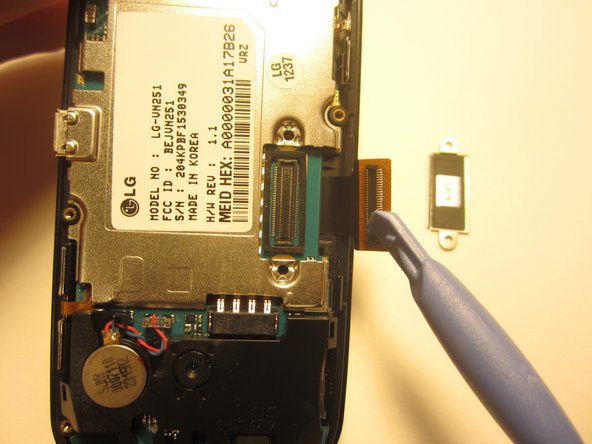

      • Rotate the phone 180 degrees and use the plastic opener to lift the metal piece that covers the ribbon cable.
    3. LG Cosmos 2 Motherboard Replacement: crwdns2935265:07crwdnd2935265:01crwdnd2935265:02crwdne2935265:0 LG Cosmos 2 Motherboard Replacement: crwdns2935265:07crwdnd2935265:02crwdnd2935265:02crwdne2935265:0
      • Use the plastic opener to disconnect the ribbon cable.
    4. LG Cosmos 2 Motherboard Replacement: crwdns2935265:08crwdnd2935265:01crwdnd2935265:02crwdne2935265:0 LG Cosmos 2 Motherboard Replacement: crwdns2935265:08crwdnd2935265:02crwdnd2935265:02crwdne2935265:0
      • Use tweezers to disconnect the two cables that attach the motherboard to the case.
      • Note: Pull on the cables gently to prevent damage for future use.
    5. LG Cosmos 2 Motherboard Replacement: crwdns2935265:09crwdnd2935265:01crwdnd2935265:01crwdne2935265:0
      • Remove the motherboard from the front case.
