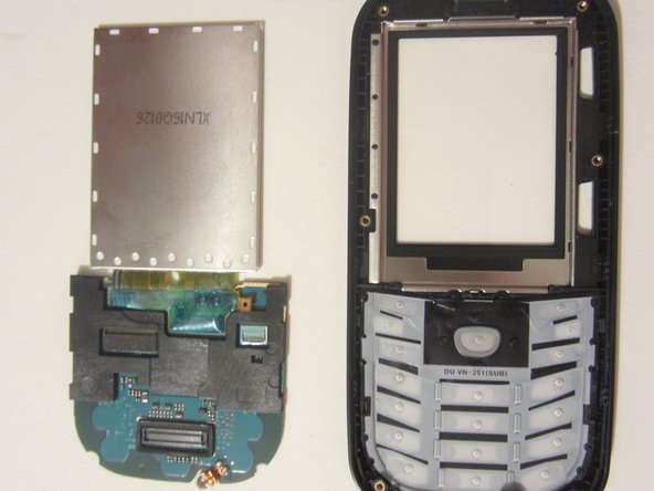

    1. LG Cosmos 2 LCD Display Replacement, LCD Display: crwdns2935265:018crwdnd2935265:01crwdnd2935265:02crwdne2935265:0 LG Cosmos 2 LCD Display Replacement, LCD Display: crwdns2935265:018crwdnd2935265:02crwdnd2935265:02crwdne2935265:0
      • Use a tool to pry open the LCD display. Remove the display and the circuit board that it's connected to.
    2. LG Cosmos 2 LCD Display Replacement: crwdns2935265:019crwdnd2935265:01crwdnd2935265:01crwdne2935265:0
      • Remove the plastic piece from the circuit board by unlocking the switch on the plastic piece with a pair of tweezers.

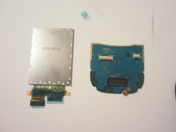

    3. LG Cosmos 2 LCD Display Replacement: crwdns2935265:020crwdnd2935265:01crwdnd2935265:01crwdne2935265:0
      • Using a pair of tweezers, remove the tape.
    4. LG Cosmos 2 LCD Display Replacement: crwdns2935265:021crwdnd2935265:01crwdnd2935265:01crwdne2935265:0
      • Using either your finger or the plastic opener, disconnect the cable.
    5. LG Cosmos 2 LCD Display Replacement: crwdns2935265:022crwdnd2935265:01crwdnd2935265:02crwdne2935265:0 LG Cosmos 2 LCD Display Replacement: crwdns2935265:022crwdnd2935265:02crwdnd2935265:02crwdne2935265:0
      • Pull the LCD display away from the circuit board.
      • You shouldn't feel any resistance. If you notice resistance, make sure you have completed the previous step.
