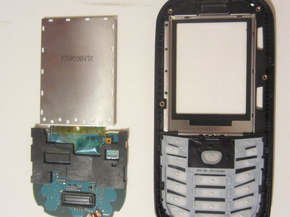

  18. LG Cosmos 2 Front Keyboard Replacement, Front Keyboard: crwdns2935265:018crwdnd2935265:01crwdnd2935265:02crwdne2935265:0 LG Cosmos 2 Front Keyboard Replacement, Front Keyboard: crwdns2935265:018crwdnd2935265:02crwdnd2935265:02crwdne2935265:0
    • Use a tool to pry open the LCD display. Remove the display and the motherboard-looking device that it's connected to.
  19. LG Cosmos 2 Front Keyboard Replacement: crwdns2935265:019crwdnd2935265:01crwdnd2935265:01crwdne2935265:0
    • Rotate and remove the keypad from the front case.
