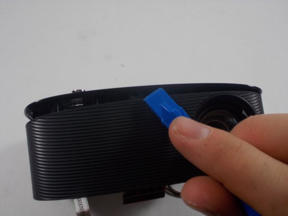

    • Remove three 6 mm screws on the bottom plate with a Phillips #00 screwdriver.
  2. LG CineBeam Wi-Fi and Bluetooth Card Replacement: crwdns2935265:02crwdnd2935265:01crwdnd2935265:03crwdne2935265:0 LG CineBeam Wi-Fi and Bluetooth Card Replacement: crwdns2935265:02crwdnd2935265:02crwdnd2935265:03crwdne2935265:0 LG CineBeam Wi-Fi and Bluetooth Card Replacement: crwdns2935265:02crwdnd2935265:03crwdnd2935265:03crwdne2935265:0
    • Using an iFixit opening tool, pry the bottom plate off of the device and remove it fully.

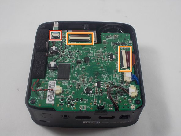

  3. LG CineBeam Wi-Fi and Bluetooth Card Replacement, Motherboard: crwdns2935265:03crwdnd2935265:01crwdnd2935265:03crwdne2935265:0 LG CineBeam Wi-Fi and Bluetooth Card Replacement, Motherboard: crwdns2935265:03crwdnd2935265:02crwdnd2935265:03crwdne2935265:0 LG CineBeam Wi-Fi and Bluetooth Card Replacement, Motherboard: crwdns2935265:03crwdnd2935265:03crwdnd2935265:03crwdne2935265:0

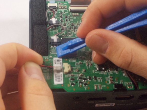

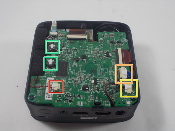

    • Using an iFixit opening tool, press down the lever on the top of the minilock connector for the speaker and pull the plug out gently.
    • Repeat this process to remove the WiFi/Bluetooth card connector.
    • Remove the battery connector.
    • Remove the fan connectors.

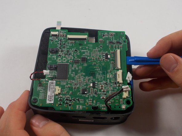

  4. LG CineBeam Wi-Fi and Bluetooth Card Replacement: crwdns2935265:04crwdnd2935265:01crwdnd2935265:02crwdne2935265:0 LG CineBeam Wi-Fi and Bluetooth Card Replacement: crwdns2935265:04crwdnd2935265:02crwdnd2935265:02crwdne2935265:0
    • Using an iFixit opening tool, pry up the black plastic tabs on the back of the power button/joystick board cable.
    • Gently pull the ribbon cable out of the socket.
    • Repeat this process for the two display cables.

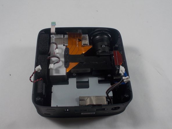

  5. LG CineBeam Wi-Fi and Bluetooth Card Replacement: crwdns2935265:05crwdnd2935265:01crwdnd2935265:03crwdne2935265:0 LG CineBeam Wi-Fi and Bluetooth Card Replacement: crwdns2935265:05crwdnd2935265:02crwdnd2935265:03crwdne2935265:0 LG CineBeam Wi-Fi and Bluetooth Card Replacement: crwdns2935265:05crwdnd2935265:03crwdnd2935265:03crwdne2935265:0
    • Lift the motherboard out of the casing.

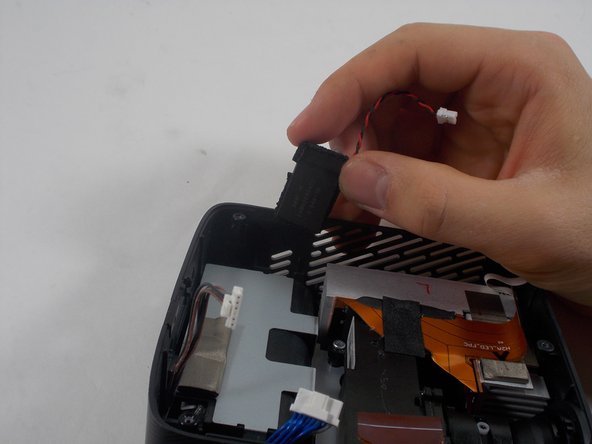

  6. LG CineBeam Wi-Fi and Bluetooth Card Replacement, Speaker: crwdns2935265:06crwdnd2935265:01crwdnd2935265:02crwdne2935265:0 LG CineBeam Wi-Fi and Bluetooth Card Replacement, Speaker: crwdns2935265:06crwdnd2935265:02crwdnd2935265:02crwdne2935265:0
    • Use your fingers to lift the speaker from the casing.

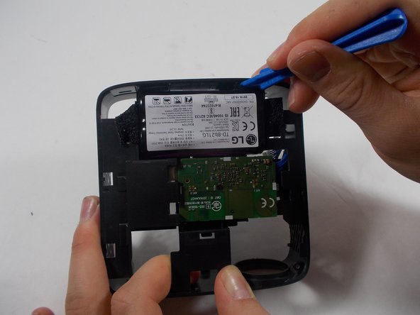

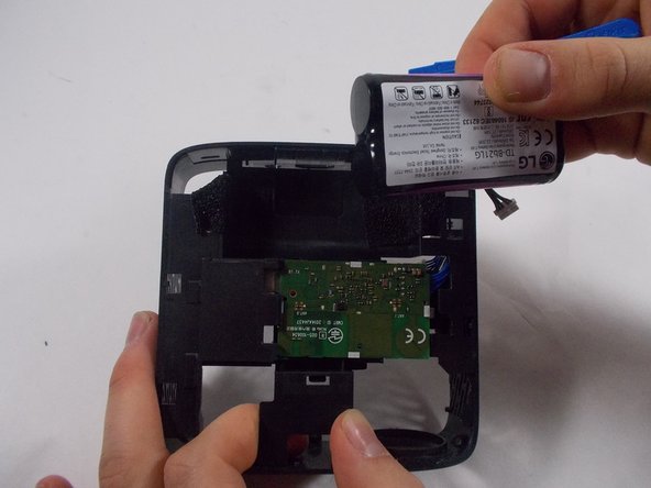

  7. LG CineBeam Wi-Fi and Bluetooth Card Replacement, Battery: crwdns2935265:07crwdnd2935265:01crwdnd2935265:03crwdne2935265:0 LG CineBeam Wi-Fi and Bluetooth Card Replacement, Battery: crwdns2935265:07crwdnd2935265:02crwdnd2935265:03crwdne2935265:0 LG CineBeam Wi-Fi and Bluetooth Card Replacement, Battery: crwdns2935265:07crwdnd2935265:03crwdnd2935265:03crwdne2935265:0
    • Turn the device over so the power button is facing up.
    • Using an iFixit opening tool, pry open the top of the plastic casing and remove it completely.
  8. LG CineBeam Wi-Fi and Bluetooth Card Replacement: crwdns2935265:08crwdnd2935265:01crwdnd2935265:03crwdne2935265:0 LG CineBeam Wi-Fi and Bluetooth Card Replacement: crwdns2935265:08crwdnd2935265:02crwdnd2935265:03crwdne2935265:0 LG CineBeam Wi-Fi and Bluetooth Card Replacement: crwdns2935265:08crwdnd2935265:03crwdnd2935265:03crwdne2935265:0
    • Using an iFixit opening tool, remove the battery.

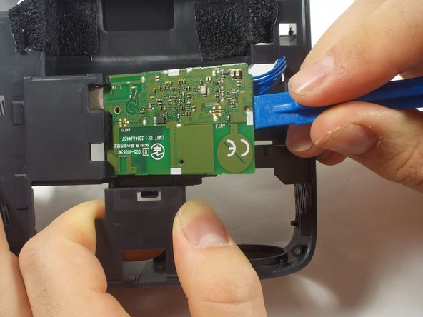

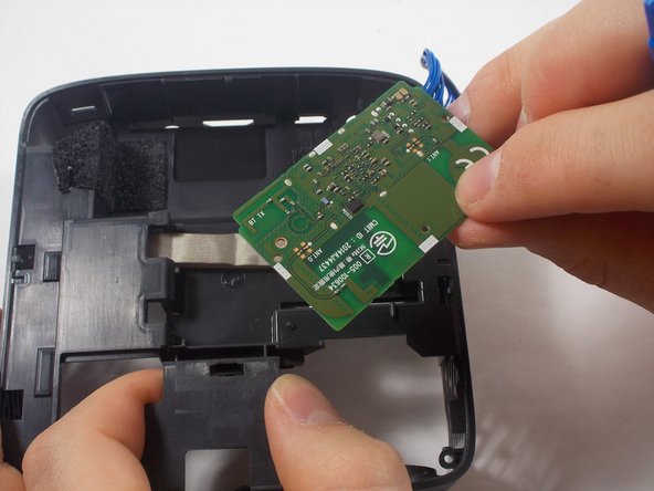

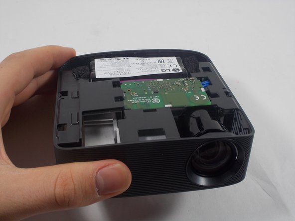

  9. LG CineBeam Wi-Fi and Bluetooth Card Replacement, Wi-Fi and Bluetooth Card: crwdns2935265:09crwdnd2935265:01crwdnd2935265:03crwdne2935265:0 LG CineBeam Wi-Fi and Bluetooth Card Replacement, Wi-Fi and Bluetooth Card: crwdns2935265:09crwdnd2935265:02crwdnd2935265:03crwdne2935265:0 LG CineBeam Wi-Fi and Bluetooth Card Replacement, Wi-Fi and Bluetooth Card: crwdns2935265:09crwdnd2935265:03crwdnd2935265:03crwdne2935265:0
    • Using an iFixit opening tool, move the plastic clip on the right side of the board out of the way.
    • Using an iFixit opening tool, pry the Wi-Fi and Bluetooth card out of its socket.
