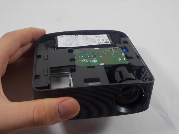

      • Lift the motherboard out of the casing.

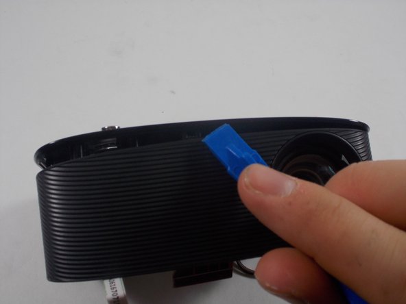

      • Turn the device over so the power button is facing up.
      • Using an iFixit opening tool, pry open the top of the plastic casing and remove it completely.

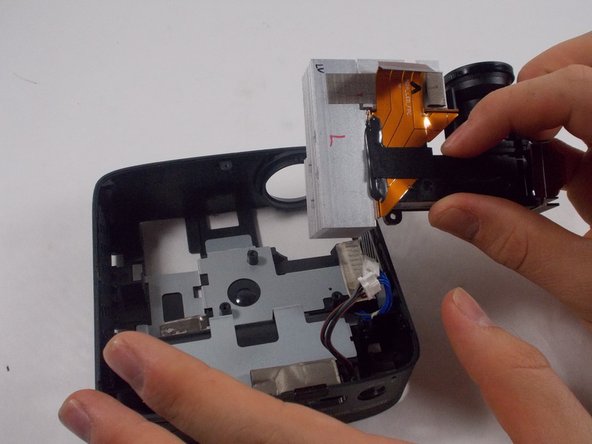

      • Remove the three 6 mm screws holding the lens and LCoS assembly in place using a Phillips #00 screwdriver.
      • Remove the lens and LCoS assembly from the casing.

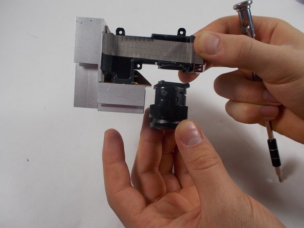

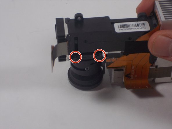

      • Remove the 4 mm screws using a Phillips #00 screwdriver.
      • Pull the lens assembly off of the display assembly.
      • When putting in a new lens assembly, make sure the focus knob is on the correct side.
