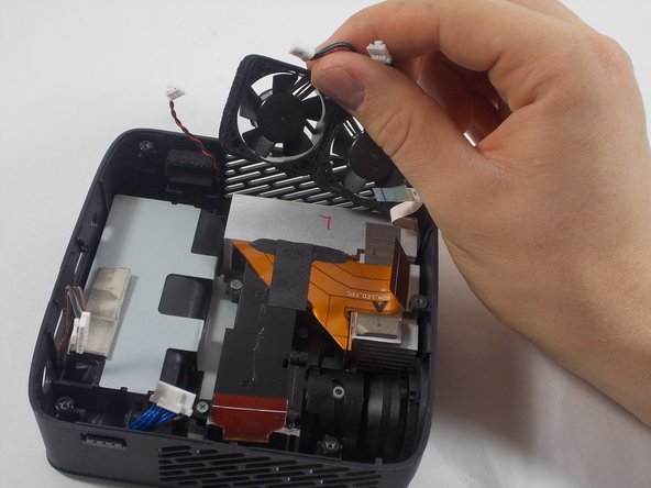

    1. LG CineBeam Fan Replacement, Fan: crwdns2935265:06crwdnd2935265:01crwdnd2935265:02crwdne2935265:0 LG CineBeam Fan Replacement, Fan: crwdns2935265:06crwdnd2935265:02crwdnd2935265:02crwdne2935265:0
      • Use your hands to lift the fans out of the projector.
