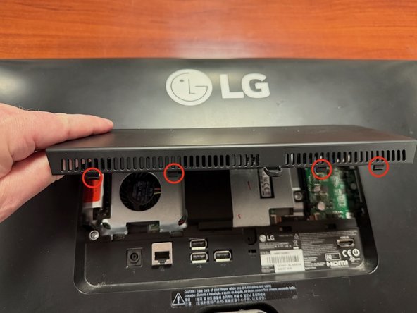

  2. LG Chromebase 22" Teardown, Open the Rear Hatch: crwdns2935265:02crwdnd2935265:01crwdnd2935265:02crwdne2935265:0 LG Chromebase 22" Teardown, Open the Rear Hatch: crwdns2935265:02crwdnd2935265:02crwdnd2935265:02crwdne2935265:0
    • Remove the screw above the debug switch hole. Then pry up the hatch by releasing the four latches circled in this picture. After this, the hatch can be raised and pulled downward.

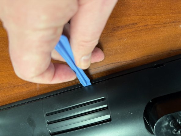

  4. LG Chromebase 22" Teardown, Remove the Rear Cover: crwdns2935265:04crwdnd2935265:01crwdnd2935265:03crwdne2935265:0 LG Chromebase 22" Teardown, Remove the Rear Cover: crwdns2935265:04crwdnd2935265:02crwdnd2935265:03crwdne2935265:0 LG Chromebase 22" Teardown, Remove the Rear Cover: crwdns2935265:04crwdnd2935265:03crwdnd2935265:03crwdne2935265:0
    • Begin to release the cover by prying it apart in the center hole. Then work your way around the cover with a spudger, releasing the clips along the way. Release the clips on the bottom and sides, then work your way to the center. Be careful around the top center to avoid damaging the webcam.

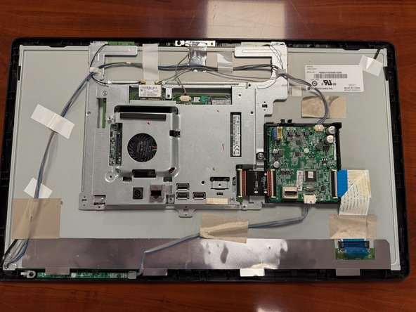

  5. LG Chromebase 22" Teardown, Remove the Motherboard Frame: crwdns2935265:05crwdnd2935265:01crwdnd2935265:03crwdne2935265:0 LG Chromebase 22" Teardown, Remove the Motherboard Frame: crwdns2935265:05crwdnd2935265:02crwdnd2935265:03crwdne2935265:0 LG Chromebase 22" Teardown, Remove the Motherboard Frame: crwdns2935265:05crwdnd2935265:03crwdnd2935265:03crwdne2935265:0

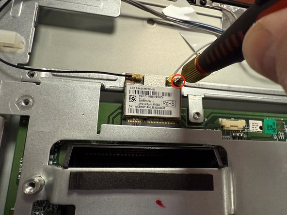

    • Detach the webcam cable using a spudger. You will probably break the clip, but it will still reconnect. Next, remove the Wi-Fi card by removing the screw and lifting it out. This is required to remove the motherboard in the next step.
    • You do not need to detach the Wi-Fi antennas or other cables. Just remove the tape and slide them out of the way.

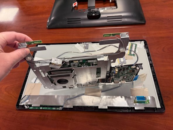

    • Leave the video board attached to the motherboard frame. You should be able to raise the entire frame without detaching the control cable from the video board.
  6. LG Chromebase 22" Teardown, Remove the Motherboard: crwdns2935265:06crwdnd2935265:01crwdnd2935265:01crwdne2935265:0
    • The motherboard is protected by the steel frame, with the back facing the screen. You can lift the entire frame without detaching many cables, only the webcam and Wi-Fi card.
    • Remove the five circled screws to release the motherboard. Then slide it straight out of the frame, releasing the Ethernet and USB ports.

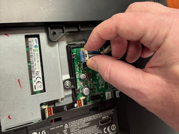

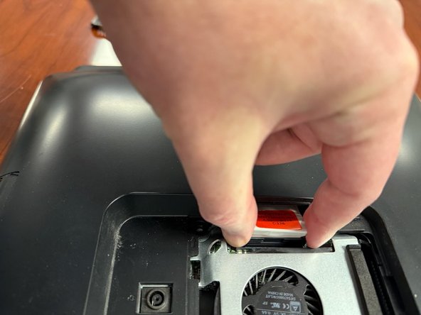

  7. LG Chromebase 22" Teardown, Replace the RAM: crwdns2935265:07crwdnd2935265:01crwdnd2935265:01crwdne2935265:0
    • You can hinge the motherboard out of the frame without releasing the video card cable. This will give you access to the RAM slot.
    • The Chromebase uses standard a PC3L-12800 SO-DIMM. This is a low-power (1.35 V) chip commonly used in Atom and Celeron machines and laptops of the era, including the Intel NUC. Most Chromebase machines have 2 GB or RAM, though some reportedly have a 4 GB SO-DIMM. I replaced mine with an 8 GB SO-DIMM and it works perfectly.
    • There are no other user-upgradeable components, though the Wi-Fi card is easy to replace.
    • Reassembly is the reverse process. Remember to leave the center screw out in case you want to flash the BIOS. Be careful to tape the cables back in place and reinstall the rest of the screws.
    • The case simply pops back together with some pressure. The hatch is also easy to pop back into place.
