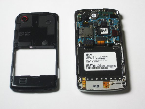

  4. LG Chocolate Touch VX-8575 LCD Screen Replacement: crwdns2935265:04crwdnd2935265:01crwdnd2935265:02crwdne2935265:0 LG Chocolate Touch VX-8575 LCD Screen Replacement: crwdns2935265:04crwdnd2935265:02crwdnd2935265:02crwdne2935265:0
    • In the next step, be gentle with the plastic back case when prying it away from the phone because it is attached with adhesives on the bottom side of the phone. If you try to force the back case off, you may crack it.
    • Use a plastic opener tool to gently pry off the back case by sliding it in between the back case and the main body of the phone and loosening it around the edges.
    • Be patient, it may take several tries to remove the back case successfully.
    • After pulling off the black back case of the phone, you should now see the logic board and other internal components.

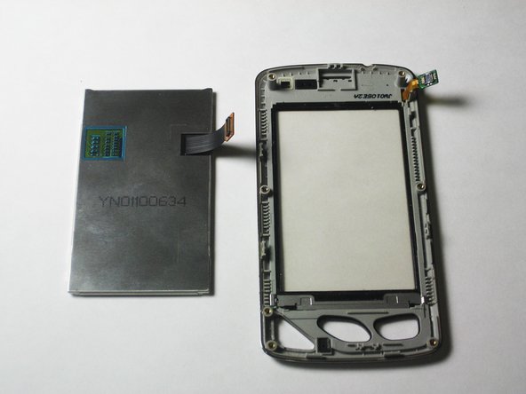

  9. LG Chocolate Touch VX-8575 LCD Screen Replacement, LCD Screen: crwdns2935265:09crwdnd2935265:01crwdnd2935265:02crwdne2935265:0 LG Chocolate Touch VX-8575 LCD Screen Replacement, LCD Screen: crwdns2935265:09crwdnd2935265:02crwdnd2935265:02crwdne2935265:0
    • Place the front cover face down and locate the LCD screen. It is the large silver rectangle with a light blue square on the left-hand side.
    • In the next step, be gentle while removing the LCD screen. If you jerk the LCD screen off, it may crack, so be careful and slowly peel away the adhesive.
    • To detatch the LCD screen, use a plastic wedge or your fingers and slowly pull the screen away from the front cover.
