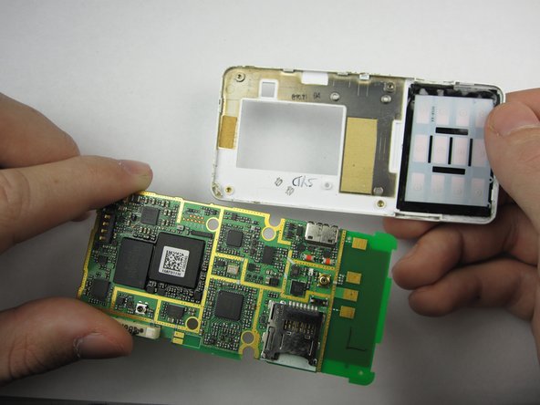

    1. LG Chocolate Motherboard Replacement, Motherboard: crwdns2935265:04crwdnd2935265:01crwdnd2935265:02crwdne2935265:0 LG Chocolate Motherboard Replacement, Motherboard: crwdns2935265:04crwdnd2935265:02crwdnd2935265:02crwdne2935265:0
      • Carefully pry the motherboard off of the back case
