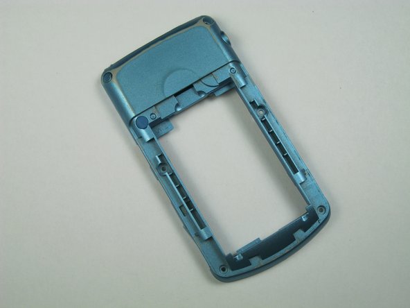

  3. LG Chocolate 3 Keypad Replacement, Rear Case: crwdns2935265:03crwdnd2935265:01crwdnd2935265:01crwdne2935265:0
    • Use the pointed end of the spudger to pull out the plastic inserts that are located on the left and right-hand corners.
    • If needed, use the tip of a push pin instead of the spudger to remove the plastic inserts.

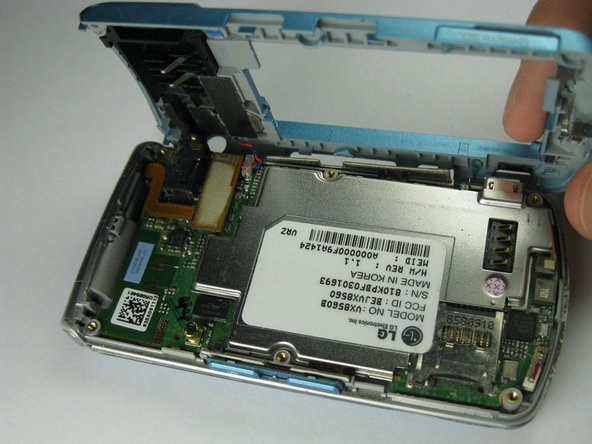

  5. LG Chocolate 3 Keypad Replacement: crwdns2935265:05crwdnd2935265:01crwdnd2935265:02crwdne2935265:0 LG Chocolate 3 Keypad Replacement: crwdns2935265:05crwdnd2935265:02crwdnd2935265:02crwdne2935265:0
    • Pull the rear case up using the spudger.
    • The rear case is connected to the right side of the phone via red and blue cables, be careful not to pull these cables out.
    • The volume control buttons on the side might fall out of their sockets. Carefully replace them with a pair of tweezers before you reassemble the rear case.
  6. LG Chocolate 3 Keypad Replacement: crwdns2935265:06crwdnd2935265:01crwdnd2935265:01crwdne2935265:0
    • Use tweezers to pull the clear end of the red and blue speaker cables away from motherboard.
  7. LG Chocolate 3 Keypad Replacement: crwdns2935265:07crwdnd2935265:01crwdnd2935265:02crwdne2935265:0 LG Chocolate 3 Keypad Replacement: crwdns2935265:07crwdnd2935265:02crwdnd2935265:02crwdne2935265:0
    • Carefully remove the rear case from the phone.

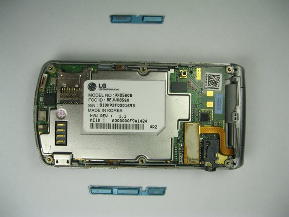

  8. LG Chocolate 3 Keypad Replacement, Side Buttons: crwdns2935265:08crwdnd2935265:01crwdnd2935265:01crwdne2935265:0
    • Use tweezers to remove the music button found on the side of the phone.
  9. LG Chocolate 3 Keypad Replacement: crwdns2935265:09crwdnd2935265:01crwdnd2935265:02crwdne2935265:0 LG Chocolate 3 Keypad Replacement: crwdns2935265:09crwdnd2935265:02crwdnd2935265:02crwdne2935265:0
    • Use tweezers to remove the volume control buttons on the opposite side of the phone.
