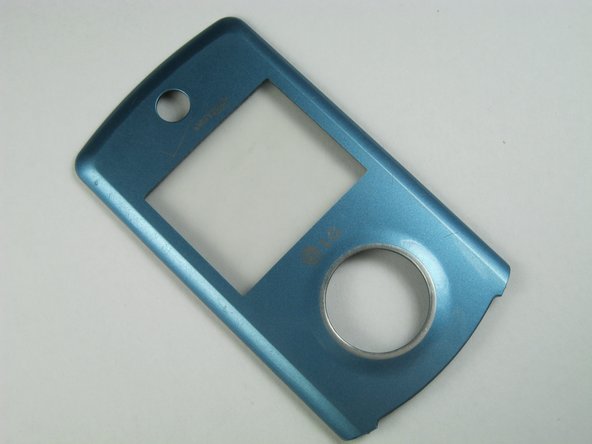

    • Use the plastic opening tool to lift the front faceplate from the device.
    • The faceplate has adhesive in multiple areas. Loosen the faceplate around all of the edges first to make it easier to remove.
  2. LG Chocolate 3 Front Faceplate Replacement: crwdns2935265:02crwdnd2935265:01crwdnd2935265:01crwdne2935265:0
    • The scroll wheel has an orange display data cable attached which may rip from excessive force.
    • Lift the front faceplate up gently.
  3. LG Chocolate 3 Front Faceplate Replacement: crwdns2935265:03crwdnd2935265:01crwdnd2935265:01crwdne2935265:0
    • Be careful not to rip the orange display data cable or drop the scroll wheel on the LCD screen.
    • Use the flat end of the spudger to pry the scroll wheel from the faceplate.
  4. LG Chocolate 3 Front Faceplate Replacement: crwdns2935265:04crwdnd2935265:01crwdnd2935265:02crwdne2935265:0 LG Chocolate 3 Front Faceplate Replacement: crwdns2935265:04crwdnd2935265:02crwdnd2935265:02crwdne2935265:0
    • Separate the front faceplate from the device completely.
