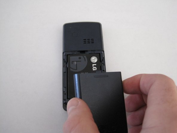

    • Slide the back cover down using your finger to remove the cover from the phone.

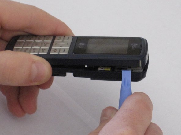

  7. LG CG180 Display Replacement: crwdns2935265:07crwdnd2935265:01crwdnd2935265:01crwdne2935265:0
    • Insert a plastic opening tool in the seam.
  8. LG CG180 Display Replacement: crwdns2935265:08crwdnd2935265:01crwdnd2935265:02crwdne2935265:0 LG CG180 Display Replacement: crwdns2935265:08crwdnd2935265:02crwdnd2935265:02crwdne2935265:0
    • Run the tool along the seam to release all the tabs.

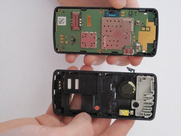

  9. LG CG180 Display Replacement: crwdns2935265:09crwdnd2935265:01crwdnd2935265:02crwdne2935265:0 LG CG180 Display Replacement: crwdns2935265:09crwdnd2935265:02crwdnd2935265:02crwdne2935265:0
    • Pull the phone back cover off once all the tabs are released.
  10. LG CG180 Display Replacement: crwdns2935265:010crwdnd2935265:01crwdnd2935265:01crwdne2935265:0
    • Push the contents of the phone away from the hardshell case by applying pressure to the keypad with both thumbs.
  11. LG CG180 Display Replacement: crwdns2935265:011crwdnd2935265:01crwdnd2935265:01crwdne2935265:0
    • The hardshell case is separated from the rest of the phone.

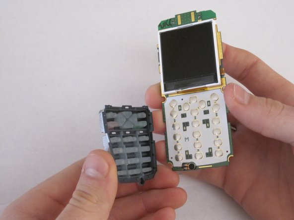

  12. LG CG180 Display Replacement, Keypad: crwdns2935265:012crwdnd2935265:01crwdnd2935265:02crwdne2935265:0 LG CG180 Display Replacement, Keypad: crwdns2935265:012crwdnd2935265:02crwdnd2935265:02crwdne2935265:0
    • Separate keypad from circuit board by turning it upside down and allowing it to fall off.

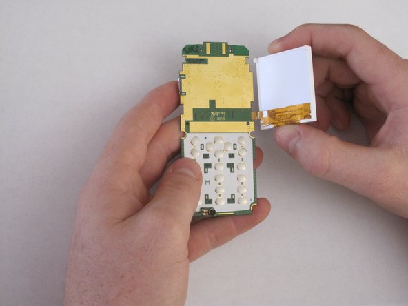

  15. LG CG180 Display Replacement: crwdns2935265:015crwdnd2935265:01crwdnd2935265:02crwdne2935265:0 LG CG180 Display Replacement: crwdns2935265:015crwdnd2935265:02crwdnd2935265:02crwdne2935265:0
    • Once both clips are released, turn over the circuit board so that the display is facing upward.
    • Carefully lift the display from the left side and open to the right.
  16. LG CG180 Display Replacement: crwdns2935265:016crwdnd2935265:01crwdnd2935265:01crwdne2935265:0
    • Carefully remove the electrical tape from the display.
  17. LG CG180 Display Replacement: crwdns2935265:017crwdnd2935265:01crwdnd2935265:01crwdne2935265:0
    • The display is disconnected from the circuit board.
