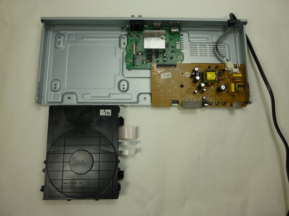

      • Using your fingers, pull the three tape-like cables to disconnect the disc drive from the green motherboard.
    4. LG BP220 Motherboard Replacement: crwdns2935265:04crwdnd2935265:01crwdnd2935265:02crwdne2935265:0 LG BP220 Motherboard Replacement: crwdns2935265:04crwdnd2935265:02crwdnd2935265:02crwdne2935265:0
      • Remove the two black 3/16” Phillips #2 mounting screws from the left and right side of the disc drive.
      • With the front side facing you lift the front of disc drive, slide it toward you and pull out to remove.

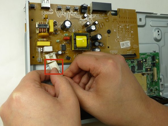

      • Detach the power supply cord from the brown motherboard by pushing the locking clip on the connector, and pulling out.
      • The connector may be difficult to remove. Wiggling it while pulling out may help release it.

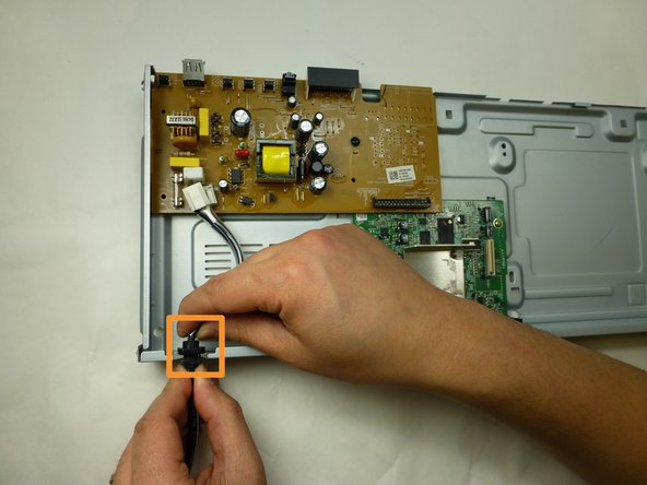

      • Remove the power cord from the panel by carefully sliding it upwards from its seating.

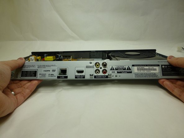

      • Remove the two black 3/16” Phillips #2 screws from the backside of the player.
      • One screw inbetween the audio/video jacks
      • One screw to the bottom right of the audio/video jacks
      • With the backside facing you, pull the bottom of the panel towards you and lift to remove it.

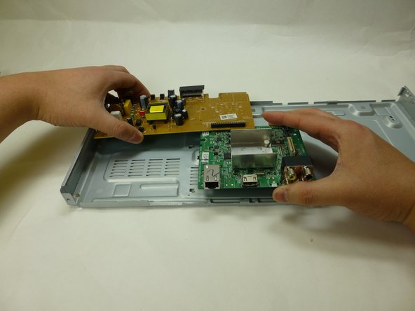

      • Handle the motherboards with care. They are fragile.
      • Beware of the capacitors as they may shock you when touched.
      • Remove the the two silver 3/16” Phillips #2 screws from the green motherboard.
      • Remove the one black 3/16” Phillips #2 screw from the brown motherboard
      • Use both hands to carefully lift the motherboard unit away from the player.
