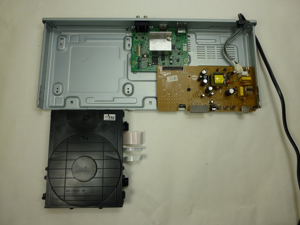

      • Ensure the device is unplugged to prevent shocks.
      • Remove the three black 3/16” Phillips #2 screws from the backside of the player.
      • With the backside (audio/video jacks) facing you, lift the part of the cover closer to you and pull until it is off.
    2. LG BP220 Disc Drive Replacement: crwdns2935265:02crwdnd2935265:01crwdnd2935265:01crwdne2935265:0
      • Using your fingers, pull the three tape-like cables to disconnect the disc drive from the green motherboard.
    3. LG BP220 Disc Drive Replacement: crwdns2935265:03crwdnd2935265:01crwdnd2935265:03crwdne2935265:0 LG BP220 Disc Drive Replacement: crwdns2935265:03crwdnd2935265:02crwdnd2935265:03crwdne2935265:0 LG BP220 Disc Drive Replacement: crwdns2935265:03crwdnd2935265:03crwdnd2935265:03crwdne2935265:0
      • Unhinge the tabs that attach the front panel to the unit:
      • Two tabs on the disc drive
      • Two tabs on the left and right side of the player
      • Be careful when handling these tabs. They are very fragile and can be easily broken.
      • Three tabs on the underside of the player
      • Pull panel away from case.
      • If the panel does not come off right away, be sure to check if tabs have inadvertently switched back to their locked position.
    4. LG BP220 Disc Drive Replacement: crwdns2935265:04crwdnd2935265:01crwdnd2935265:02crwdne2935265:0 LG BP220 Disc Drive Replacement: crwdns2935265:04crwdnd2935265:02crwdnd2935265:02crwdne2935265:0
      • Remove the two black 3/16” Phillips #2 mounting screws from the left and right side of the disc drive.
      • With the front side facing you lift the front of disc drive and pull out to remove.
