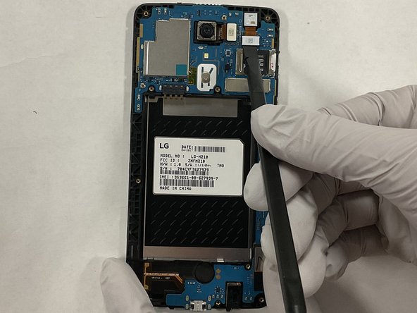

  5. LG Aristo MS210 Front and Rear Camera Replacement, Front and Rear Camera: crwdns2935265:05crwdnd2935265:01crwdnd2935265:03crwdne2935265:0 LG Aristo MS210 Front and Rear Camera Replacement, Front and Rear Camera: crwdns2935265:05crwdnd2935265:02crwdnd2935265:03crwdne2935265:0 LG Aristo MS210 Front and Rear Camera Replacement, Front and Rear Camera: crwdns2935265:05crwdnd2935265:03crwdnd2935265:03crwdne2935265:0
    • Use the spudger to disconnect the ZIF connector securing the front-facing camera.
  6. LG Aristo MS210 Front and Rear Camera Replacement: crwdns2935265:06crwdnd2935265:01crwdnd2935265:03crwdne2935265:0 LG Aristo MS210 Front and Rear Camera Replacement: crwdns2935265:06crwdnd2935265:02crwdnd2935265:03crwdne2935265:0 LG Aristo MS210 Front and Rear Camera Replacement: crwdns2935265:06crwdnd2935265:03crwdnd2935265:03crwdne2935265:0
    • Use the spudger disconnect the ZIF connector securing the back-facing camera.

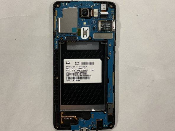

  7. LG Aristo MS210 Front and Rear Camera Replacement: crwdns2935265:07crwdnd2935265:01crwdnd2935265:01crwdne2935265:0
    • Remove both the front and back facing cameras.
