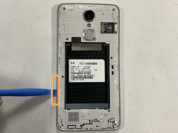

    • Insert the spudger into the notch on the bottom left side of the phone.
    • Apply light pressure to remove the back cover.

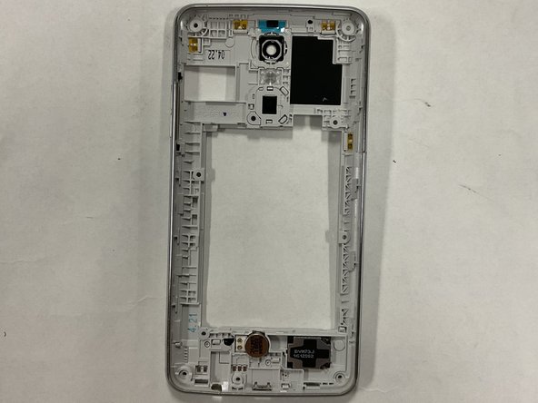

    • Use the PH000 bit unscrew the ten 3.4mm screws as highlighted.
    • Use the spudger to remove the inner shell.
    • Flip the inner shell over to expose the clips holding the command button.
  4. LG Aristo MS210 Command Button Replacement: crwdns2935265:04crwdnd2935265:01crwdnd2935265:03crwdne2935265:0 LG Aristo MS210 Command Button Replacement: crwdns2935265:04crwdnd2935265:02crwdnd2935265:03crwdne2935265:0 LG Aristo MS210 Command Button Replacement: crwdns2935265:04crwdnd2935265:03crwdnd2935265:03crwdne2935265:0
    • Use the spudger disconnect the three clips holding in the command button as highlighted.
    • Remove the command button.
