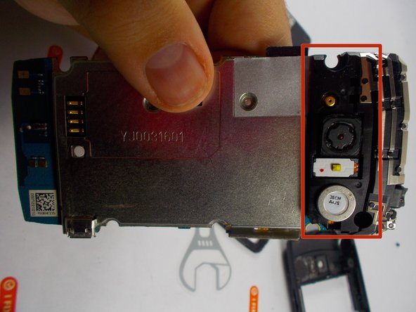

      • Using your prying tool, lift the green circuit board platform off the black casing and gently disconnect the connection point between the tether and the green circuit board.
      • Flip phone over, and notice where the camera lies on the other side, there are three small clips connecting a black casing over the section of the phone. Gently using your hands or the prying tool, take these clips off.
    5. LG Ally VS740 Camera Flash Replacement: crwdns2935265:05crwdnd2935265:01crwdnd2935265:01crwdne2935265:0
      • The white rectangle with the yellow square is the flash. Gently lift up and disconnect flash module. Take your new flash and aligning the connection point to the connection hole, push it down firmly until it is snug in place. Follow the steps backwards to put phone back together.
