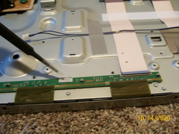

    2. LG 55UH6150 backlight LED replacement, Remove lower speaker bracket and power button: crwdns2935265:02crwdnd2935265:01crwdnd2935265:02crwdne2935265:0 LG 55UH6150 backlight LED replacement, Remove lower speaker bracket and power button: crwdns2935265:02crwdnd2935265:02crwdnd2935265:02crwdne2935265:0
      • A few screws on the bottom and two plugs disconnected and the black bottom panel is removed. Now you can disconnect the display power connectors. There are 2 long green circuit boards (LCD drivers)strips at the bottom.

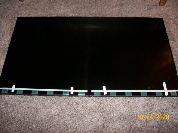

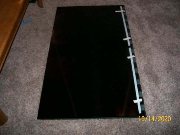

    5. LG 55UH6150 backlight LED replacement, Secure PCB and cable to front of display: crwdns2935265:05crwdnd2935265:01crwdnd2935265:01crwdne2935265:0
      • Now you'll need to remove the plastic frame that holds the display and filters in place. A series of "snaps" need to be un-clipped . Carefully fold over the printed circuit boards and cables and tape them to the front of the display. This part is tricky as you'll need to stand up the display carefully without having the filters fall out.

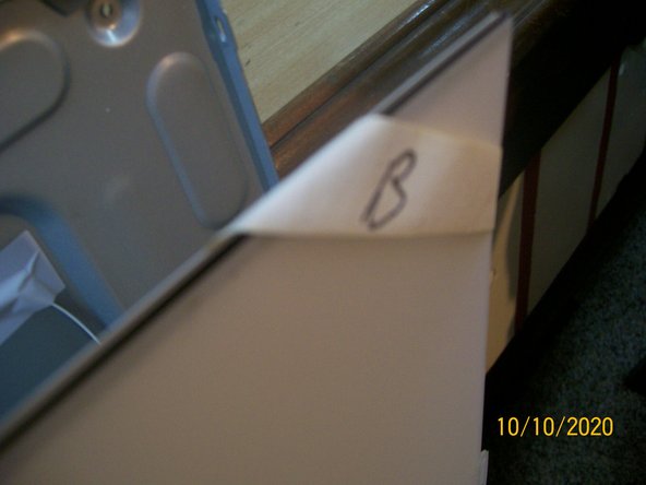

    6. LG 55UH6150 backlight LED replacement, Tape screen and filters together.  KEEP THEM SAFE: crwdns2935265:06crwdnd2935265:01crwdnd2935265:02crwdne2935265:0 LG 55UH6150 backlight LED replacement, Tape screen and filters together.  KEEP THEM SAFE: crwdns2935265:06crwdnd2935265:02crwdnd2935265:02crwdne2935265:0
      • Tape all the filters and diffuser together. You don't want them falling out. By now I hope your putting all the pieces in a safe place. We will need to reassemble them, (I hope.) I marked them "B" for bottom.

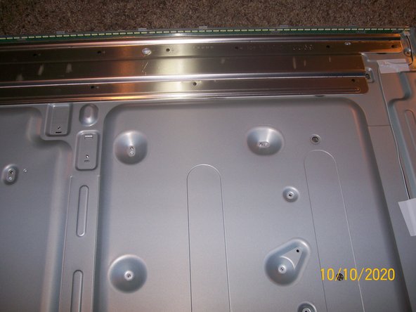

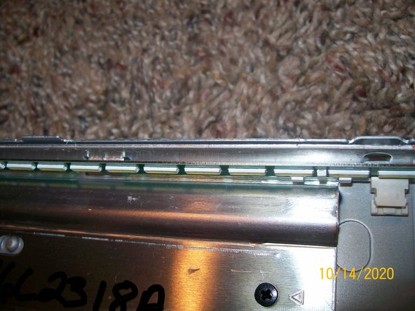

    7. LG 55UH6150 backlight LED replacement, LED's exposed: crwdns2935265:07crwdnd2935265:01crwdnd2935265:03crwdne2935265:0 LG 55UH6150 backlight LED replacement, LED's exposed: crwdns2935265:07crwdnd2935265:02crwdnd2935265:03crwdne2935265:0 LG 55UH6150 backlight LED replacement, LED's exposed: crwdns2935265:07crwdnd2935265:03crwdnd2935265:03crwdne2935265:0
      • Here we can finally see the LED strips attached to the bottom of the frame. You can see the connectors. You can disconnect these now as we will attempt to remove them. They are held in place with thin, double-sided tape.
    8. LG 55UH6150 backlight LED replacement, Remove LED strip: crwdns2935265:08crwdnd2935265:01crwdnd2935265:01crwdne2935265:0
      • I started the removal process by inserting a thin metal tool between the strip and the frame. The tape came loose from the frame and stayed on the strip. I moved the tool down the length, prying very lightly. We'll be replacing these but I wanted to do the least amount of damage to them . I still need to read the part number off of them.

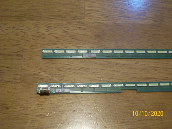

    9. LG 55UH6150 backlight LED replacement, The LED strips are out!!: crwdns2935265:09crwdnd2935265:01crwdnd2935265:03crwdne2935265:0 LG 55UH6150 backlight LED replacement, The LED strips are out!!: crwdns2935265:09crwdnd2935265:02crwdnd2935265:03crwdne2935265:0 LG 55UH6150 backlight LED replacement, The LED strips are out!!: crwdns2935265:09crwdnd2935265:03crwdnd2935265:03crwdne2935265:0
      • As you can clearly see, LEDs 2 and 4 on the bottom strip are burnt out. I verified this with a magnifying glass. This strip was from the right side that went dark. Next step is to order strips 6916L2318A and 6916L2319A and replace them and put this TV back together.

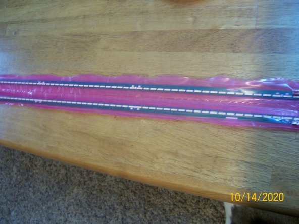

    10. LG 55UH6150 backlight LED replacement, Re-assemble with new LED strips: crwdns2935265:010crwdnd2935265:01crwdnd2935265:03crwdne2935265:0 LG 55UH6150 backlight LED replacement, Re-assemble with new LED strips: crwdns2935265:010crwdnd2935265:02crwdnd2935265:03crwdne2935265:0 LG 55UH6150 backlight LED replacement, Re-assemble with new LED strips: crwdns2935265:010crwdnd2935265:03crwdnd2935265:03crwdne2935265:0
      • The new LED strips came in today and I started to re-assemble the display. Thanks "shopjimmy.com" for having the strips and keeping me away from the Chinese ones on e-bay. The two strips cost me $63.00 total. They arrived in good shape.

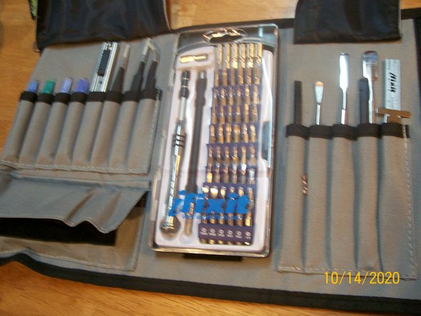

    11. LG 55UH6150 backlight LED replacement: crwdns2935265:011crwdnd2935265:01crwdnd2935265:03crwdne2935265:0 LG 55UH6150 backlight LED replacement: crwdns2935265:011crwdnd2935265:02crwdnd2935265:03crwdne2935265:0 LG 55UH6150 backlight LED replacement: crwdns2935265:011crwdnd2935265:03crwdnd2935265:03crwdne2935265:0
      • The tools I used and the strips ready for installation. The fine people at LG make it fool proof to insert the new strips by putting a cutout in the strip and a tab in the frame. REMEMBER to test fit the plug into the connector. One side of my LED had misaligned pin that I had to straighten to get the plug to fit. Very difficult to do in frame.

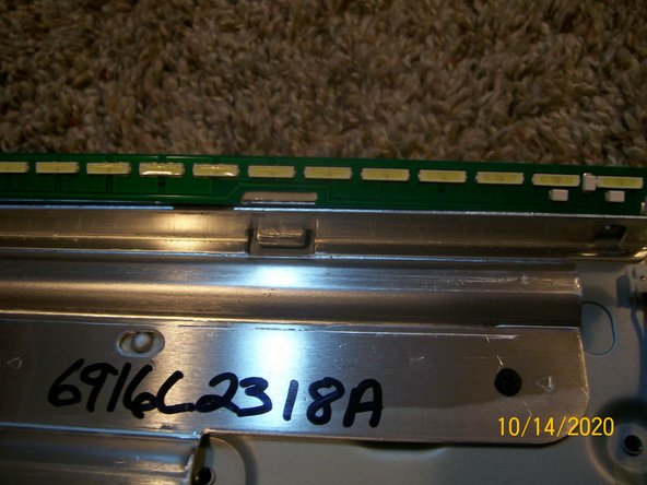

    12. LG 55UH6150 backlight LED replacement, Attaching the LED's to the frame: crwdns2935265:012crwdnd2935265:01crwdnd2935265:03crwdne2935265:0 LG 55UH6150 backlight LED replacement, Attaching the LED's to the frame: crwdns2935265:012crwdnd2935265:02crwdnd2935265:03crwdne2935265:0 LG 55UH6150 backlight LED replacement, Attaching the LED's to the frame: crwdns2935265:012crwdnd2935265:03crwdnd2935265:03crwdne2935265:0
      • Carefully peal the backing off of the strip and lay it in the position over the tabs. Make sure you keep the sticky side away from the frame for now. When the strip is lined up where it needs to be, carefully push it into position into the frame. This tape is not forgiving so make sure it perfectly straight and flat to the frame, top and bottom

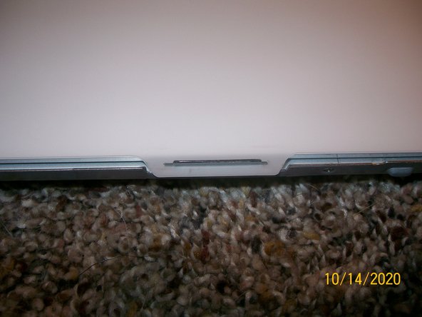

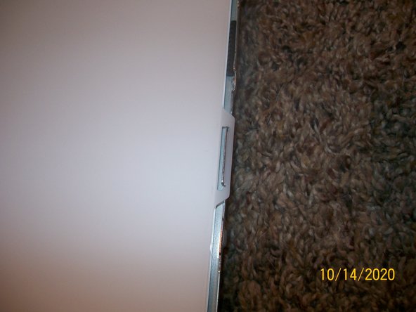

    13. LG 55UH6150 backlight LED replacement, Replace the filters and reflectors: crwdns2935265:013crwdnd2935265:01crwdnd2935265:03crwdne2935265:0 LG 55UH6150 backlight LED replacement, Replace the filters and reflectors: crwdns2935265:013crwdnd2935265:02crwdnd2935265:03crwdne2935265:0 LG 55UH6150 backlight LED replacement, Replace the filters and reflectors: crwdns2935265:013crwdnd2935265:03crwdnd2935265:03crwdne2935265:0
      • Snap in the black plastic frame. Again the fine people at LG helped with tabs on the frame and slots on the filters. You can't install them upside down. Carefully align the tabs with the slots and make sure they are flat and centered into the frame. You really can't mess this part up unless to forgot to tape them together when disassembling.
    14. LG 55UH6150 backlight LED replacement, Replace the filters and black plastic frame: crwdns2935265:014crwdnd2935265:01crwdnd2935265:03crwdne2935265:0 LG 55UH6150 backlight LED replacement, Replace the filters and black plastic frame: crwdns2935265:014crwdnd2935265:02crwdnd2935265:03crwdne2935265:0 LG 55UH6150 backlight LED replacement, Replace the filters and black plastic frame: crwdns2935265:014crwdnd2935265:03crwdnd2935265:03crwdne2935265:0
      • Once the filters are in place, make sure the filters are flat and the snaps secure. Now comes the trickery park. Replacing the glass display panel. If this goes wrong forget about this TV. A new display cost's $560.00! Lay the display into the frame CENTERED. If you find it's off center DO NOT LIFT ONLY ONE CORNER lift along the whole side.

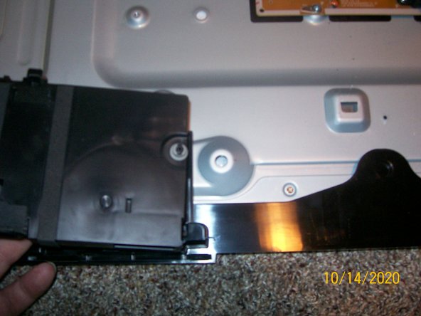

    17. LG 55UH6150 backlight LED replacement, Plug in power connector and speakers: crwdns2935265:017crwdnd2935265:01crwdnd2935265:03crwdne2935265:0 LG 55UH6150 backlight LED replacement, Plug in power connector and speakers: crwdns2935265:017crwdnd2935265:02crwdnd2935265:03crwdne2935265:0 LG 55UH6150 backlight LED replacement, Plug in power connector and speakers: crwdns2935265:017crwdnd2935265:03crwdnd2935265:03crwdne2935265:0
      • Now we install the bottom black panel that holds the power button and speakers. This photo shows the tab in the center that fits into a cutout in the frame. Slide the assembly into place and attach with 3 screws. Plug in any other connectors you may have disconnected. Check carefully, the back is going on soon and we do want this to work.

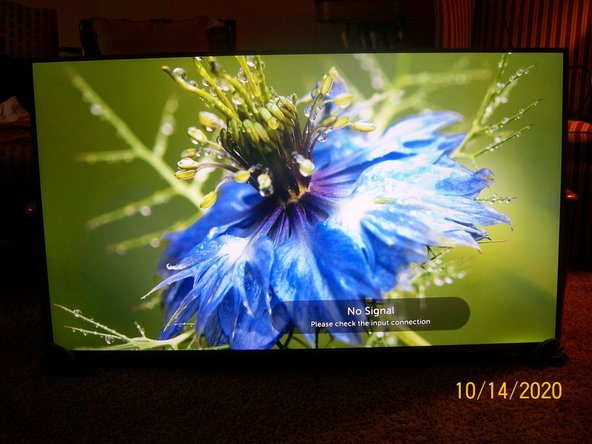

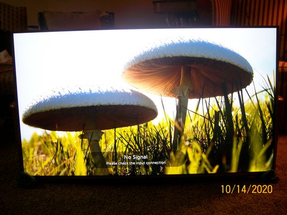

    19. LG 55UH6150 backlight LED replacement, Finished panel ready for test: crwdns2935265:019crwdnd2935265:01crwdnd2935265:01crwdne2935265:0
      • Here is the finished panel ready for testing. I kept the back off for now until I power up the unit. No telling if I forgot a cable. I stood the set up and put a couple of folded rags under each corner to hold it up off the floor so I can operate the power button. Now plug in the power cord and turn on the power.
    20. LG 55UH6150 backlight LED replacement, WOW we have a picture on BOTH sides.: crwdns2935265:020crwdnd2935265:01crwdnd2935265:03crwdne2935265:0 LG 55UH6150 backlight LED replacement, WOW we have a picture on BOTH sides.: crwdns2935265:020crwdnd2935265:02crwdnd2935265:03crwdne2935265:0 LG 55UH6150 backlight LED replacement, WOW we have a picture on BOTH sides.: crwdns2935265:020crwdnd2935265:03crwdnd2935265:03crwdne2935265:0
      • Hopefully you will see a well lit, beautiful picture like this. If you don't, check the power cord and connections at the display ribbon cable. Enjoy the TV YOU fixed. This has been a fun and rewarding project. Truth is, this set is too big for my living room. I can't use it, it was truly a labor of love. I'll leave it in the basement for now.
