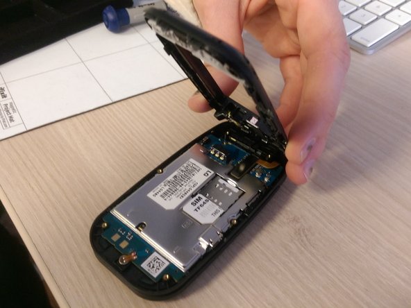

  5. LG 440G Bottom Casing Replacement, Unscrew six screws along edges of casing: crwdns2935265:05crwdnd2935265:01crwdnd2935265:01crwdne2935265:0
    • Use a Phillips #00 screw driver to remove six screws.
    • Save screws for reassembly.
  6. LG 440G Bottom Casing Replacement, Lift casing cover: crwdns2935265:06crwdnd2935265:01crwdnd2935265:02crwdne2935265:0 LG 440G Bottom Casing Replacement, Lift casing cover: crwdns2935265:06crwdnd2935265:02crwdnd2935265:02crwdne2935265:0
    • Run the plastic opening tool along the edge of the phone to release the casing cover.
    • Lift the casing cover.
