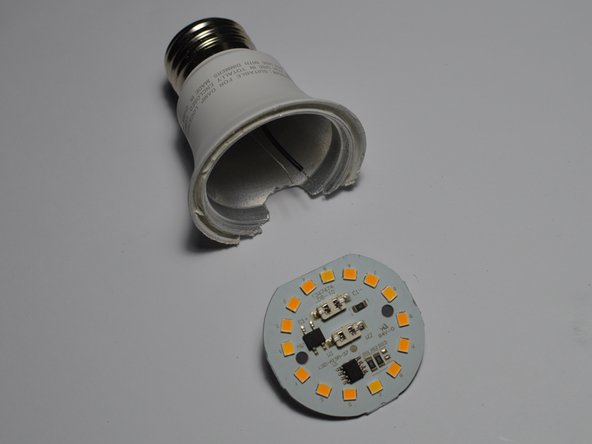

  2. LED Light Bulb Teardown, Body without Diffuser: crwdns2935265:02crwdnd2935265:01crwdnd2935265:02crwdne2935265:0 LED Light Bulb Teardown, Body without Diffuser: crwdns2935265:02crwdnd2935265:02crwdnd2935265:02crwdne2935265:0
    • 15 LEDs spread in ring.

  4. LED Light Bulb Teardown, Removing Circuit Board: crwdns2935265:04crwdnd2935265:01crwdnd2935265:03crwdne2935265:0 LED Light Bulb Teardown, Removing Circuit Board: crwdns2935265:04crwdnd2935265:02crwdnd2935265:03crwdne2935265:0 LED Light Bulb Teardown, Removing Circuit Board: crwdns2935265:04crwdnd2935265:03crwdnd2935265:03crwdne2935265:0
    • With open gap circuit board can be removed.
    • Attached with wire and resistor to base of bulb.
    • Release clips to release wires.

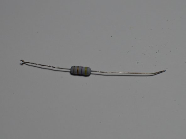

  6. LED Light Bulb Teardown, Remove Resistor: crwdns2935265:06crwdnd2935265:01crwdnd2935265:03crwdne2935265:0 LED Light Bulb Teardown, Remove Resistor: crwdns2935265:06crwdnd2935265:02crwdnd2935265:03crwdne2935265:0 LED Light Bulb Teardown, Remove Resistor: crwdns2935265:06crwdnd2935265:03crwdnd2935265:03crwdne2935265:0
    • Resistor removed by popping of bottom cap.
    • Resistor is 4.7 ohms.
