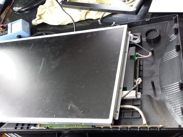

  7. LCD X2gen Display disassembly: crwdns2935265:07crwdnd2935265:01crwdnd2935265:01crwdne2935265:0
    • Prepare to remove the 4 screws on each side to lift the LCD. Do not try to remove it after unscrewing the 8 screws. There are cables connected on the back.
    • This pic shows the right side
  8. LCD X2gen Display disassembly: crwdns2935265:08crwdnd2935265:01crwdnd2935265:01crwdne2935265:0
    • This pic shows the left side
  9. LCD X2gen Display disassembly: crwdns2935265:09crwdnd2935265:01crwdnd2935265:02crwdne2935265:0 LCD X2gen Display disassembly: crwdns2935265:09crwdnd2935265:02crwdnd2935265:02crwdne2935265:0
    • Lift carefully about 2 inch to expose the back light connections, 2 pink and 2 white.
    • Slide the monitor to the left about 3-4 inch. to have access to the connections.
  10. LCD X2gen Display disassembly: crwdns2935265:010crwdnd2935265:01crwdnd2935265:01crwdne2935265:0
    • Carefully, unplug both connectors
  11. LCD X2gen Display disassembly: crwdns2935265:011crwdnd2935265:01crwdnd2935265:02crwdne2935265:0 LCD X2gen Display disassembly: crwdns2935265:011crwdnd2935265:02crwdnd2935265:02crwdne2935265:0

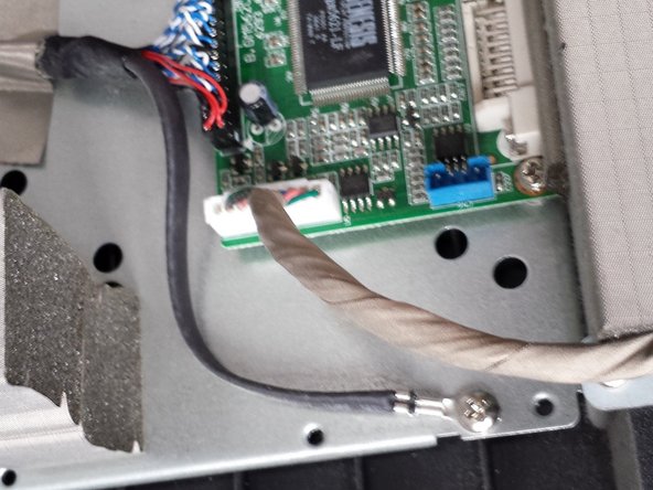

    • After removing the connectors, slide it about 3-5 inches to the right to have access to the data connector and ground
  12. LCD X2gen Display disassembly: crwdns2935265:012crwdnd2935265:01crwdnd2935265:01crwdne2935265:0
    • Remove the data connector and ground.
    • Lift display. Is now completely free
