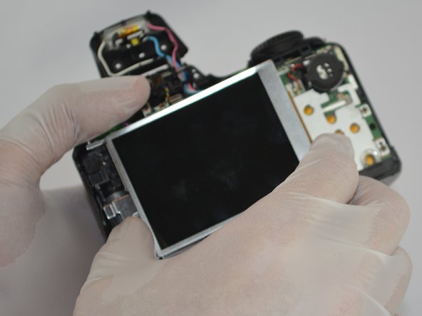

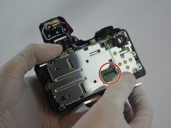

    1. LCD Screen  Replacement, LCD Screen: crwdns2935265:08crwdnd2935265:01crwdnd2935265:03crwdne2935265:0 LCD Screen  Replacement, LCD Screen: crwdns2935265:08crwdnd2935265:02crwdnd2935265:03crwdne2935265:0 LCD Screen  Replacement, LCD Screen: crwdns2935265:08crwdnd2935265:03crwdnd2935265:03crwdne2935265:0
      • Gently pull the tab out of the motherboard and then the LCD screen should easily be removed.
