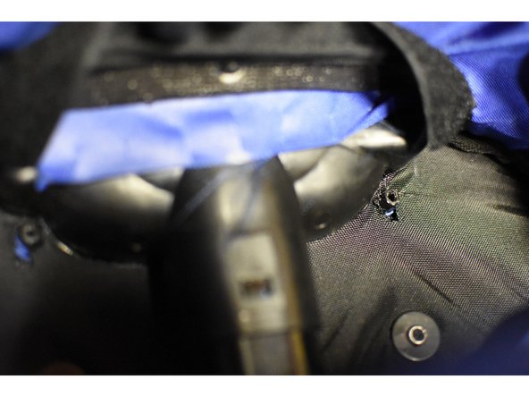

  3. L.L.Bean Rolling Backpack Handle disassembly and lubrication, Remove handle assembly- Top: crwdns2935265:03crwdnd2935265:01crwdnd2935265:03crwdne2935265:0 L.L.Bean Rolling Backpack Handle disassembly and lubrication, Remove handle assembly- Top: crwdns2935265:03crwdnd2935265:02crwdnd2935265:03crwdne2935265:0 L.L.Bean Rolling Backpack Handle disassembly and lubrication, Remove handle assembly- Top: crwdns2935265:03crwdnd2935265:03crwdnd2935265:03crwdne2935265:0
    • There are more screws holding the top of the handle assembly to the backpack.
    • Open the hook and loop fastener at the top inside of the backpack. You will find five screws- two facing the back side of the backpack, and three facing up. Remove them.
    • Remove the inner plastic piece.

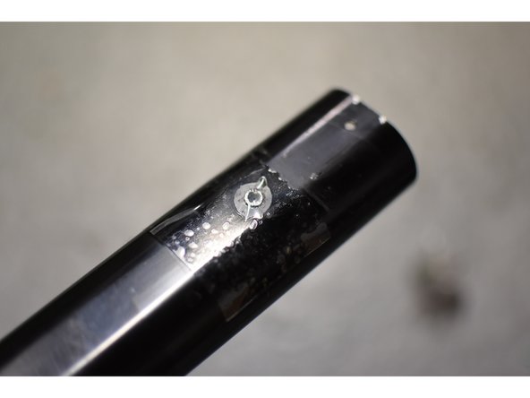

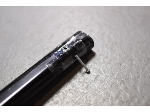

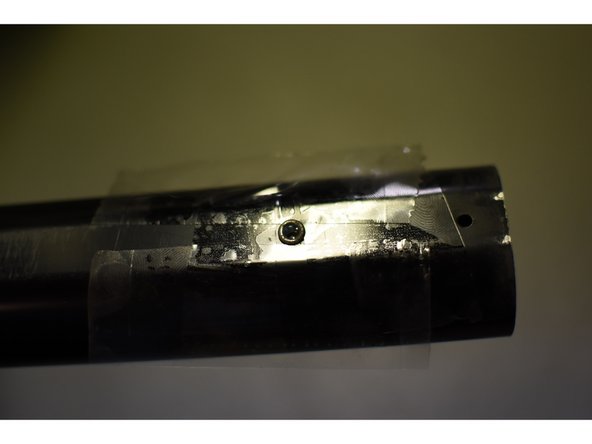

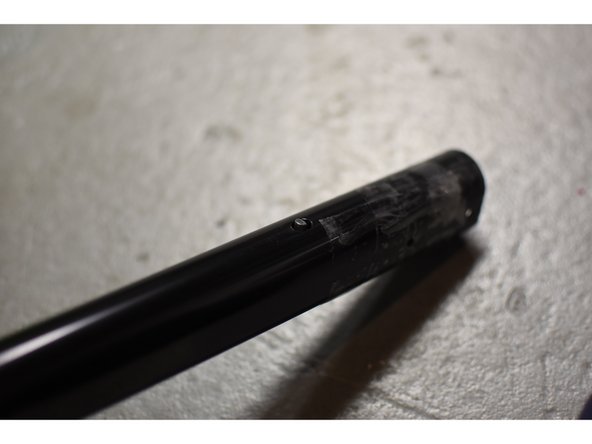

  5. L.L.Bean Rolling Backpack Handle disassembly and lubrication, A long rivet?: crwdns2935265:05crwdnd2935265:01crwdnd2935265:02crwdne2935265:0 L.L.Bean Rolling Backpack Handle disassembly and lubrication, A long rivet?: crwdns2935265:05crwdnd2935265:02crwdnd2935265:02crwdne2935265:0
    • This is the hardest part. The long rivet is preventing you from pulling the inner shaft pieces out of the assembly, so you have to remove it.
    • In this case, I've added regular tape around the rivet so that I don't scratch up the paint. Not that it matters since this piece is hidden behind the zippered cover inside the backpack.

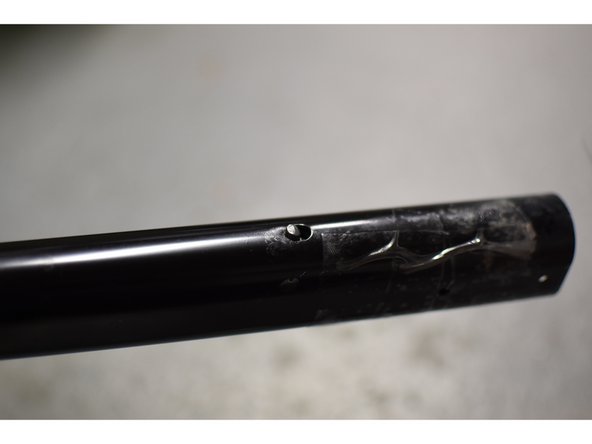

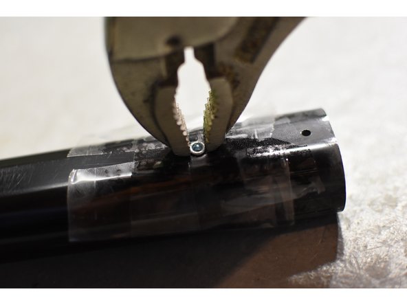

  6. L.L.Bean Rolling Backpack Handle disassembly and lubrication, Removing the rivet: crwdns2935265:06crwdnd2935265:01crwdnd2935265:03crwdne2935265:0 L.L.Bean Rolling Backpack Handle disassembly and lubrication, Removing the rivet: crwdns2935265:06crwdnd2935265:02crwdnd2935265:03crwdne2935265:0 L.L.Bean Rolling Backpack Handle disassembly and lubrication, Removing the rivet: crwdns2935265:06crwdnd2935265:03crwdnd2935265:03crwdne2935265:0
    • You're going to have to pull that rivet out somehow. Me, I used locking pliers to pinch together the flared part of the rivet.
    • Note that I used locking pliers because they were the closest tool that worked. You can use regular pliers, a hammer and chisel, or even a flat rock.
    • Now pull the rivet out. Again, note that the rivet isn't absolutely necessary- it's to hold the inner shafts in and prevent them from going down too far, but in normal operation, the inner shafts really shouldn't be hitting that rivet.

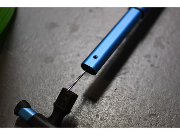

  7. L.L.Bean Rolling Backpack Handle disassembly and lubrication, Remove the handle: crwdns2935265:07crwdnd2935265:01crwdnd2935265:03crwdne2935265:0 L.L.Bean Rolling Backpack Handle disassembly and lubrication, Remove the handle: crwdns2935265:07crwdnd2935265:02crwdnd2935265:03crwdne2935265:0 L.L.Bean Rolling Backpack Handle disassembly and lubrication, Remove the handle: crwdns2935265:07crwdnd2935265:03crwdnd2935265:03crwdne2935265:0

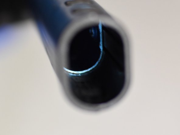

    • Use a 2.5mm hex key to remove the two screws holding the handle on and remove the handle. You may need to wiggle it a bit to remove it.
    • There will be a metal shaft that you can also pull free. Besides the kink in it to clear the screws, the shaft should not be otherwise bent. If it is, then straighten it.

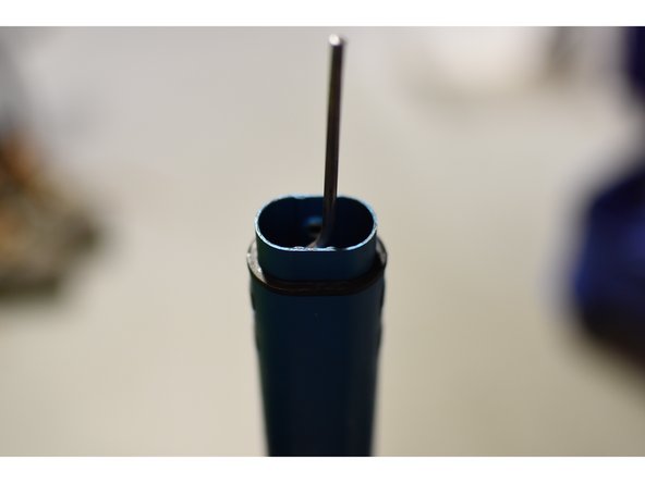

  8. L.L.Bean Rolling Backpack Handle disassembly and lubrication, Completely collapse shafts: crwdns2935265:08crwdnd2935265:01crwdnd2935265:03crwdne2935265:0 L.L.Bean Rolling Backpack Handle disassembly and lubrication, Completely collapse shafts: crwdns2935265:08crwdnd2935265:02crwdnd2935265:03crwdne2935265:0 L.L.Bean Rolling Backpack Handle disassembly and lubrication, Completely collapse shafts: crwdns2935265:08crwdnd2935265:03crwdnd2935265:03crwdne2935265:0
    • Now, push the upper shaft all the way down. You will need to push the side pins into the shafts to be able to completely collapse the shafts.

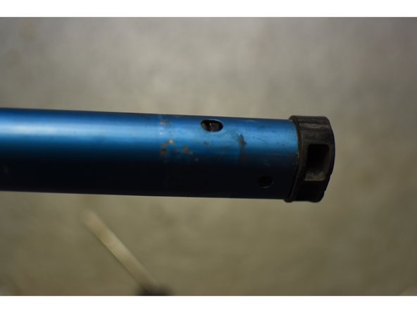

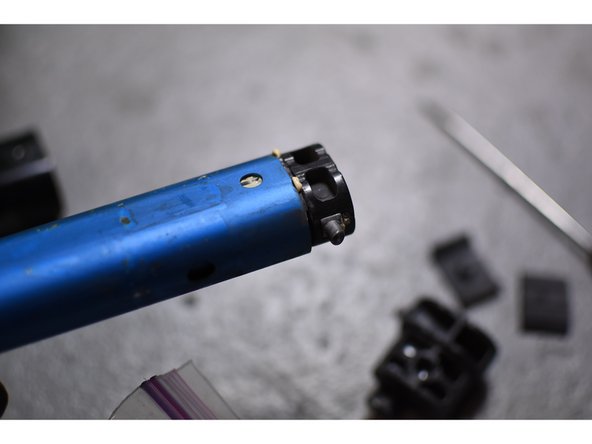

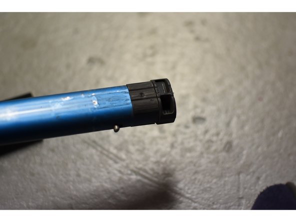

  10. L.L.Bean Rolling Backpack Handle disassembly and lubrication, Remove middle shaft cap: crwdns2935265:010crwdnd2935265:01crwdnd2935265:02crwdne2935265:0 L.L.Bean Rolling Backpack Handle disassembly and lubrication, Remove middle shaft cap: crwdns2935265:010crwdnd2935265:02crwdnd2935265:02crwdne2935265:0
    • Remove the bushings from the middle shaft (the one you just removed from the outer shaft), and pull the bottom cap off.
    • This bottom cap is probably what has been causing your problems with retraction, but we'll get to that later.

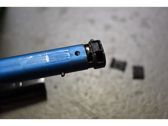

  11. L.L.Bean Rolling Backpack Handle disassembly and lubrication, Remove innermost shaft and cap: crwdns2935265:011crwdnd2935265:01crwdnd2935265:01crwdne2935265:0
    • Press the innermost shaft through the bottom of the middle shaft and remove the bottom cap from that.

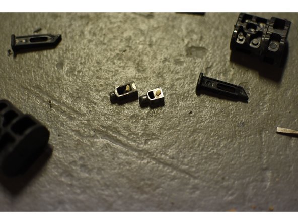

  12. L.L.Bean Rolling Backpack Handle disassembly and lubrication, The bottom caps: crwdns2935265:012crwdnd2935265:01crwdnd2935265:01crwdne2935265:0
    • You now have the two bottom caps with spring loaded pins.
    • Pressing on the plastic plunger on top of the cap should push the pin in, but excess friction may make this difficult, so you will need to add lubrication.
  13. L.L.Bean Rolling Backpack Handle disassembly and lubrication, Lubrication: crwdns2935265:013crwdnd2935265:01crwdnd2935265:02crwdne2935265:0 L.L.Bean Rolling Backpack Handle disassembly and lubrication, Lubrication: crwdns2935265:013crwdnd2935265:02crwdnd2935265:02crwdne2935265:0
    • Remove the plungers by pressing on the sides of them with something like a small screwdriver. This squeezes them together enough for the bump on the side to fit up out through the hole the plunger is in.
    • The metal pins will then come out. Be careful not to lose the springs behind those pins.
    • Now you get to lubricate the metal pins. Mine were originally covered with a dry lubricant. I can tell by how black my hands were afterwards. Oh, did I forget to tell you to wear rubber gloves?
    • Since I had no dry lubricant on hand, I just applied some grease to the angled flats, and the bottoms of the pins.

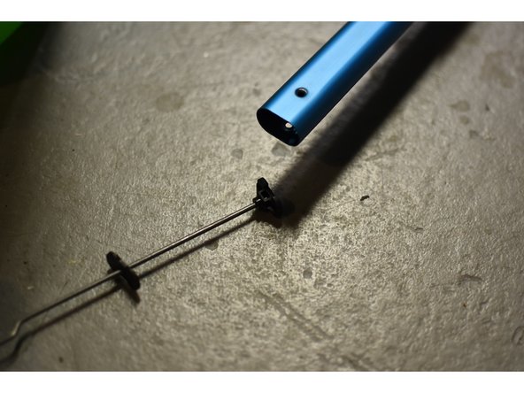

    • Press that pin in so the middle shaft sticks out the top of the outer shaft. Heck, also get the inner shaft to stick out the middle shaft. Luckily, getting the middle shaft through the upper bushing was easy.
    • You may need to put the wire plunger into the inner shaft and press it down while pulling up on the inner shaft. Hey, did you notice how easy it was to press that plunger down now that you've lubricated things?

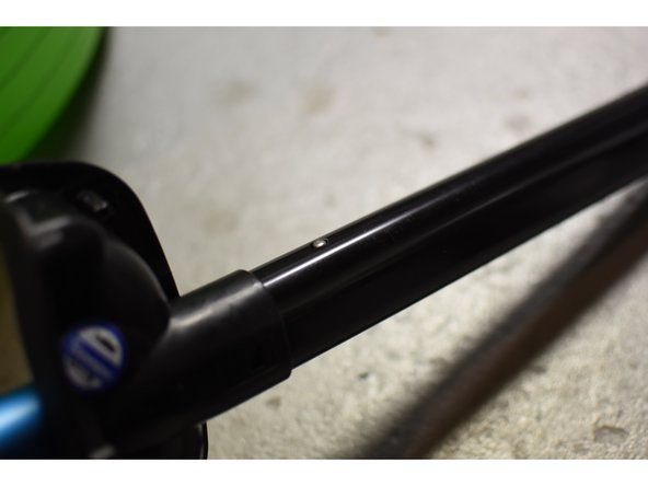

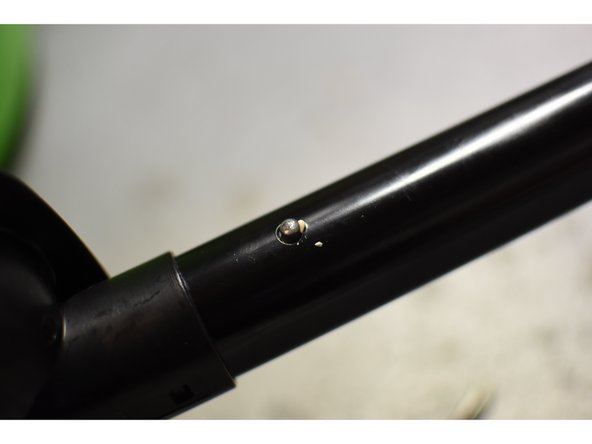

  19. L.L.Bean Rolling Backpack Handle disassembly and lubrication, Penultimate test: crwdns2935265:019crwdnd2935265:01crwdnd2935265:02crwdne2935265:0 L.L.Bean Rolling Backpack Handle disassembly and lubrication, Penultimate test: crwdns2935265:019crwdnd2935265:02crwdnd2935265:02crwdne2935265:0
    • Now you can test how well the handle retracts. Does it easily retract all the way? How about extending? When retracting, you only need to press on the button when the handle is fully retracted. At the halfway point, you mere need to push down on the top of the handle to get the middle shaft to retract.
    • Hmmm.. things weren't too smooth for me, so I'll lubricate the pin that's sticking out of the outer shaft. It looks like there's a bit of deformation of the hole. i guess someone was trying to force it.

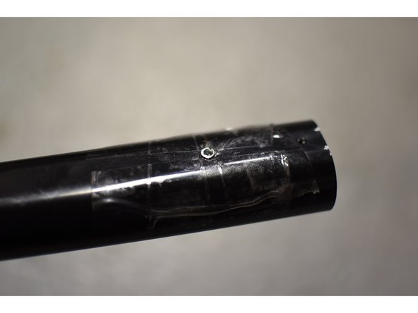

  20. L.L.Bean Rolling Backpack Handle disassembly and lubrication, The rivet: crwdns2935265:020crwdnd2935265:01crwdnd2935265:03crwdne2935265:0 L.L.Bean Rolling Backpack Handle disassembly and lubrication, The rivet: crwdns2935265:020crwdnd2935265:02crwdnd2935265:03crwdne2935265:0 L.L.Bean Rolling Backpack Handle disassembly and lubrication, The rivet: crwdns2935265:020crwdnd2935265:03crwdnd2935265:03crwdne2935265:0
    • If there's enough of the rivet left, reinsert it and try to flare the end as best as possible. I don't think it's strictly needed, but I may be missing something, so you may as well put it back just to be on the safe side.
    • You can take this time to remove the protective tape, but I also put down another piece on top of the rivet on both sides to keep the sharp edges from scratching things, and to help hold the rivet in.
