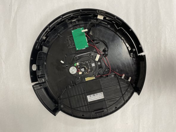

  5. Kyvol Cybovac L20 Sensor Replacement, Sensor: crwdns2935265:05crwdnd2935265:01crwdnd2935265:01crwdne2935265:0
    • Remove the eight 12.2 mm Phillips screws.
  6. Kyvol Cybovac L20 Sensor Replacement: crwdns2935265:06crwdnd2935265:01crwdnd2935265:03crwdne2935265:0 Kyvol Cybovac L20 Sensor Replacement: crwdns2935265:06crwdnd2935265:02crwdnd2935265:03crwdne2935265:0 Kyvol Cybovac L20 Sensor Replacement: crwdns2935265:06crwdnd2935265:03crwdnd2935265:03crwdne2935265:0

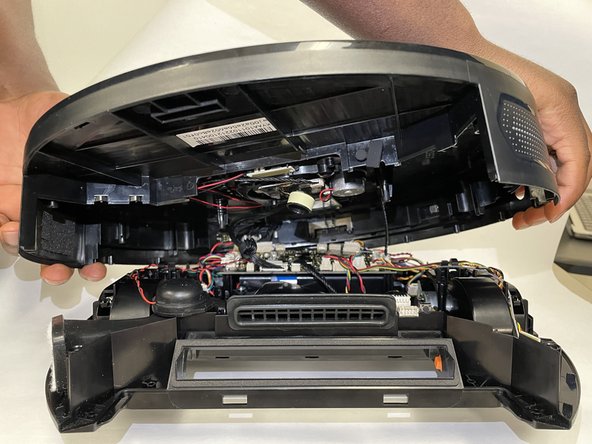

    • Lift the body away from the base and disconnect all connectors between the two halves.

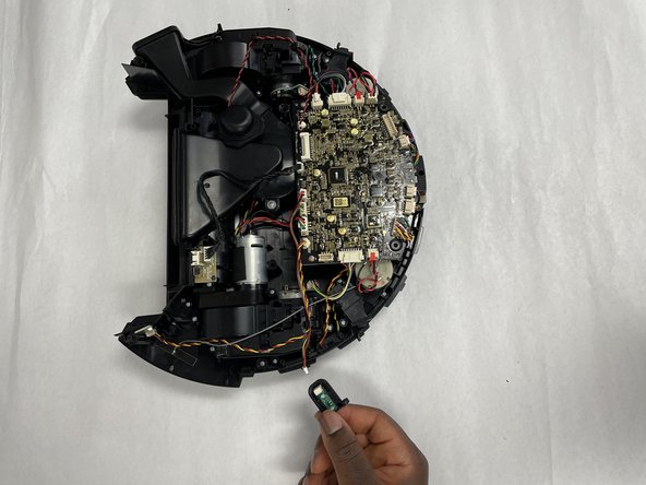

  7. Kyvol Cybovac L20 Sensor Replacement: crwdns2935265:07crwdnd2935265:01crwdnd2935265:01crwdne2935265:0
    • Remove the two 8 mm Phillips screws that secure the sensor.
  8. Kyvol Cybovac L20 Sensor Replacement: crwdns2935265:08crwdnd2935265:01crwdnd2935265:02crwdne2935265:0 Kyvol Cybovac L20 Sensor Replacement: crwdns2935265:08crwdnd2935265:02crwdnd2935265:02crwdne2935265:0
    • Use a spudger or your fingernails to gently walk the white connector directly out of its port.
    • Remove the sensor.
