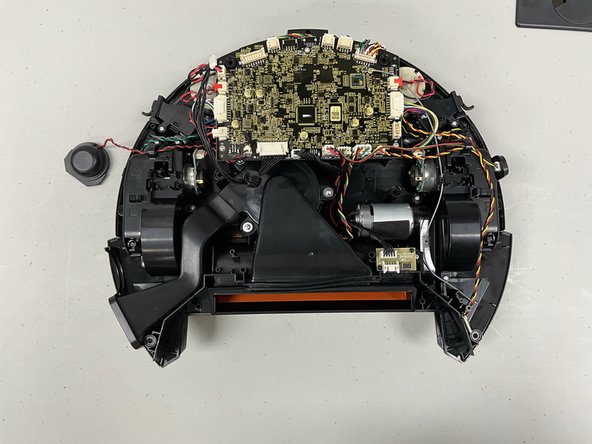

  5. Kyvol Cybovac L20 Motherboard Replacement, Motherboard: crwdns2935265:05crwdnd2935265:01crwdnd2935265:01crwdne2935265:0
    • Use a Phillips #1 screwdriver to remove 8 screws from the device as shown.
  6. Kyvol Cybovac L20 Motherboard Replacement: crwdns2935265:06crwdnd2935265:01crwdnd2935265:02crwdne2935265:0 Kyvol Cybovac L20 Motherboard Replacement: crwdns2935265:06crwdnd2935265:02crwdnd2935265:02crwdne2935265:0
    • Lift base up and unplug any cable connected form the motherboard into the rest of the components.
  7. Kyvol Cybovac L20 Motherboard Replacement: crwdns2935265:07crwdnd2935265:01crwdnd2935265:01crwdne2935265:0
    • Use a Phillips #1 screwdriver to remove the 4 screws holding the motherboard in place.
    • Lift the motherboard up and out of the chassis.
