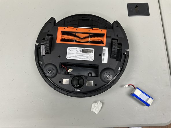

    • Begin with the device laying on a flat surface with the power button facing up.
  2. Kyvol Cybovac L20 Brush Roller Motor Replacement: crwdns2935265:02crwdnd2935265:01crwdnd2935265:02crwdne2935265:0 Kyvol Cybovac L20 Brush Roller Motor Replacement: crwdns2935265:02crwdnd2935265:02crwdnd2935265:02crwdne2935265:0
    • Remove both of the side brushes.
  3. Kyvol Cybovac L20 Brush Roller Motor Replacement: crwdns2935265:03crwdnd2935265:01crwdnd2935265:01crwdne2935265:0
    • Use a Phillips #1 screwdriver to remove two 1 mm screws that secure the panel.
    • Remove the battery panel.
  4. Kyvol Cybovac L20 Brush Roller Motor Replacement: crwdns2935265:04crwdnd2935265:01crwdnd2935265:02crwdne2935265:0 Kyvol Cybovac L20 Brush Roller Motor Replacement: crwdns2935265:04crwdnd2935265:02crwdnd2935265:02crwdne2935265:0
    • Slightly lift the battery out of the compartment.
    • Disconnect the battery connector.
    • Completely remove the battery.

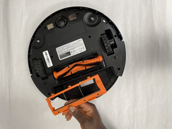

    • Remove the dust bin from the underside of the unit.
  6. Kyvol Cybovac L20 Brush Roller Motor Replacement: crwdns2935265:06crwdnd2935265:01crwdnd2935265:02crwdne2935265:0 Kyvol Cybovac L20 Brush Roller Motor Replacement: crwdns2935265:06crwdnd2935265:02crwdnd2935265:02crwdne2935265:0
    • Press in on the two clips holding the brush roller housing in place and remove the brush roller cover.
  7. Kyvol Cybovac L20 Brush Roller Motor Replacement: crwdns2935265:07crwdnd2935265:01crwdnd2935265:01crwdne2935265:0
    • Remove the brush roller.

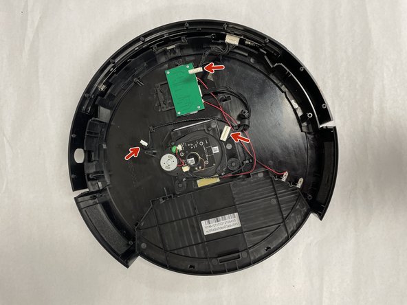

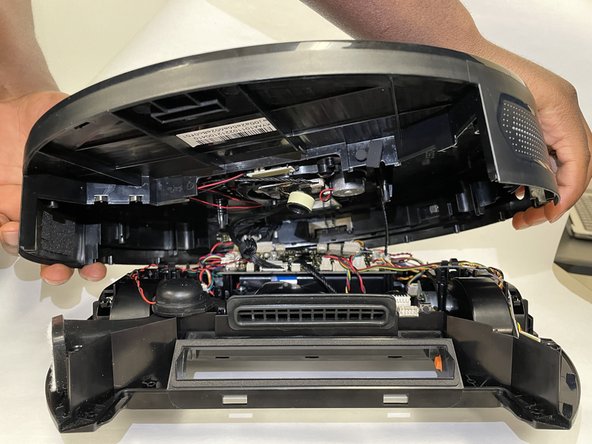

  9. Kyvol Cybovac L20 Brush Roller Motor Replacement: crwdns2935265:09crwdnd2935265:01crwdnd2935265:03crwdne2935265:0 Kyvol Cybovac L20 Brush Roller Motor Replacement: crwdns2935265:09crwdnd2935265:02crwdnd2935265:03crwdne2935265:0 Kyvol Cybovac L20 Brush Roller Motor Replacement: crwdns2935265:09crwdnd2935265:03crwdnd2935265:03crwdne2935265:0
    • Slightly lift the bottom of the unit from the top housing, with care not to pull or damage the connections between the top case and motherboard.
    • Disconnect the three motherboard connections that connect the top case and motherboard.

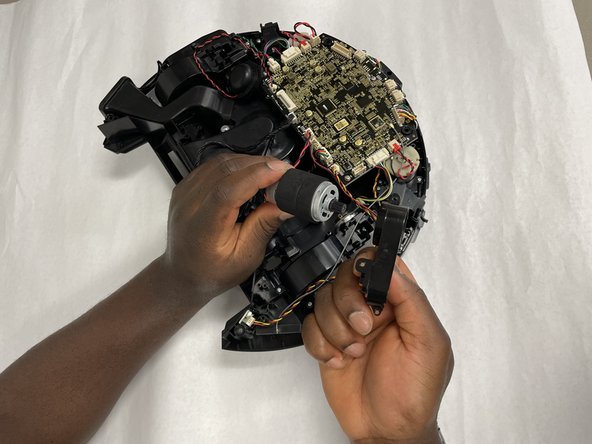

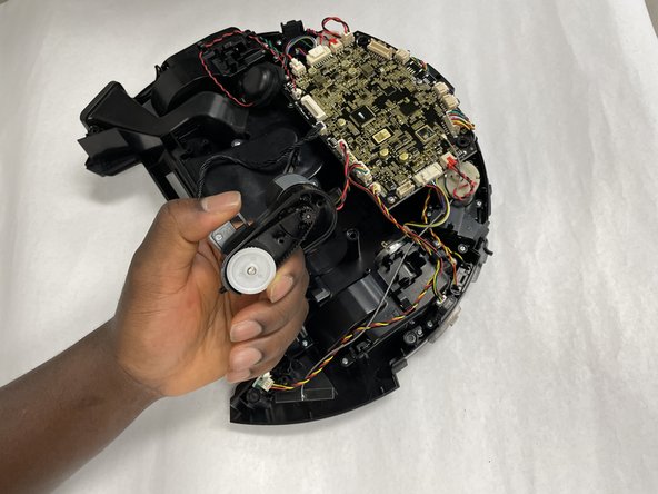

  13. Kyvol Cybovac L20 Brush Roller Motor Replacement: crwdns2935265:013crwdnd2935265:01crwdnd2935265:01crwdne2935265:0
    • Slip off the belt and pulley from the inside of the motor housing.
  14. Kyvol Cybovac L20 Brush Roller Motor Replacement: crwdns2935265:014crwdnd2935265:01crwdnd2935265:02crwdne2935265:0 Kyvol Cybovac L20 Brush Roller Motor Replacement: crwdns2935265:014crwdnd2935265:02crwdnd2935265:02crwdne2935265:0
    • Remove the two 4.5 mm Phillips screws that secure the motor to the pully assembly housing.
    • Separate the motor from the housing.

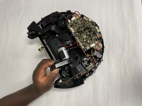

  15. Kyvol Cybovac L20 Brush Roller Motor Replacement: crwdns2935265:015crwdnd2935265:01crwdnd2935265:01crwdne2935265:0
    • Grip the white motor motherboard connect and pull it directly up and out of its port.
    • Remove the motor.
