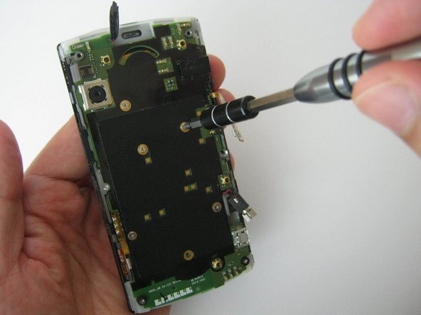

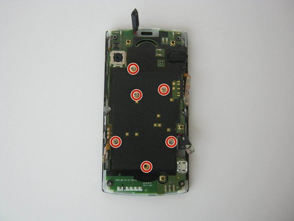

  3. Kyocera Zio M6000 Digitizer Replacement, Motherboard: crwdns2935265:03crwdnd2935265:01crwdnd2935265:02crwdne2935265:0 Kyocera Zio M6000 Digitizer Replacement, Motherboard: crwdns2935265:03crwdnd2935265:02crwdnd2935265:02crwdne2935265:0
    • Remove the six 3.18 mm screws using a Phillips 00 screwdriver.

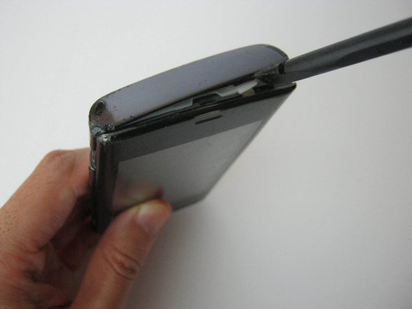

    • Insert the flat end of the spudger between the front and back panels, and pry it apart by running the spudger along the side to further separate them.
    • Go all the way around, prying as you go, until the back casing completely separates from the rest of the phone.

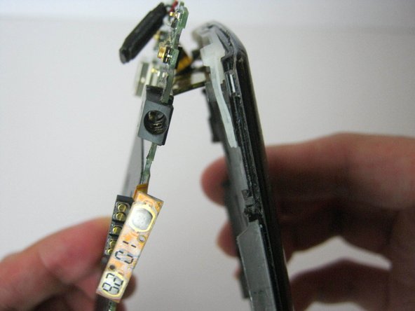

    • Unclip the two flex cables -- a small one located on the left side on the lower half of the motherboard, and a longer one on the right side, higher up.

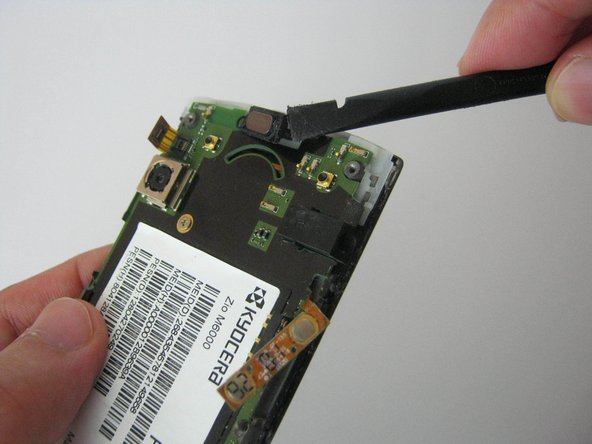

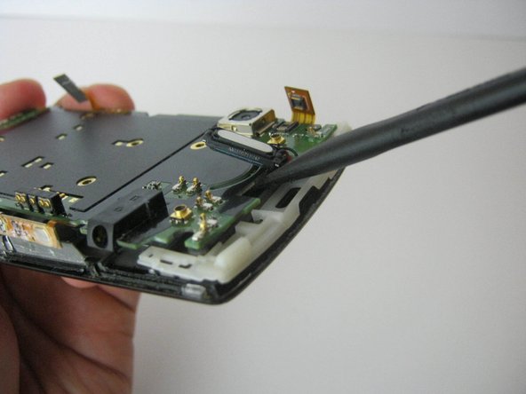

    • Pry out the earpiece speaker using the spudger.
    • Pry out the vibration motor using the spudger.

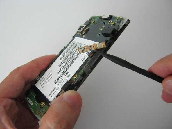

  7. Kyocera Zio M6000 Digitizer Replacement: crwdns2935265:07crwdnd2935265:01crwdnd2935265:02crwdne2935265:0 Kyocera Zio M6000 Digitizer Replacement: crwdns2935265:07crwdnd2935265:02crwdnd2935265:02crwdne2935265:0

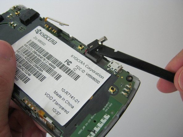

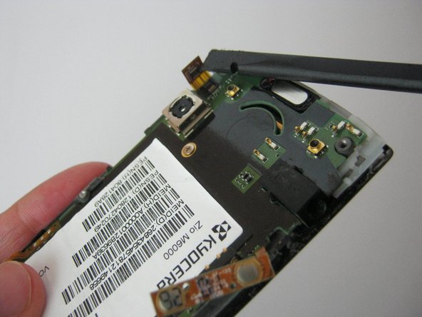

    • Place the flat end of the spudger underneath the digitizer connector and pry it up to disconnect it.

    • Lift the bottom portion of the motherboard away from the front panel.
    • Do not forcefully pull the components apart as there is another connector on the underside of the motherboard attaching it to the panel.
    • Insert the flat end of the spudger in between the panel and motherboard to unfasten the connector.

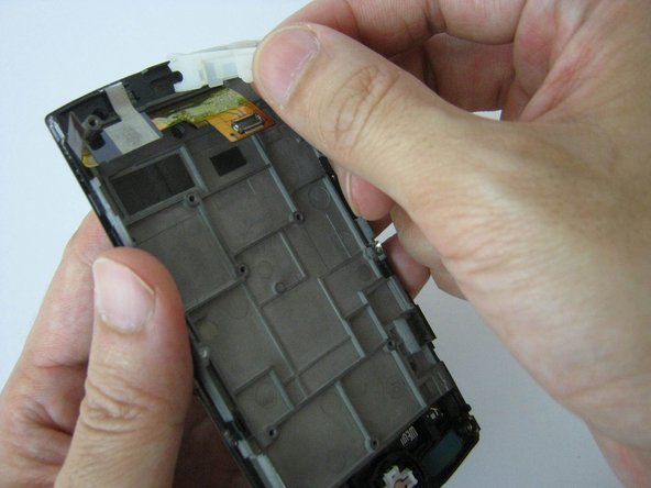

    • Remove the two rubber pieces from the ends of the panel.
  11. Kyocera Zio M6000 Digitizer Replacement: crwdns2935265:011crwdnd2935265:01crwdnd2935265:03crwdne2935265:0 Kyocera Zio M6000 Digitizer Replacement: crwdns2935265:011crwdnd2935265:02crwdnd2935265:03crwdne2935265:0 Kyocera Zio M6000 Digitizer Replacement: crwdns2935265:011crwdnd2935265:03crwdnd2935265:03crwdne2935265:0

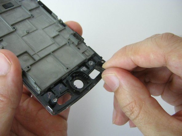

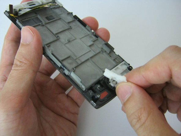

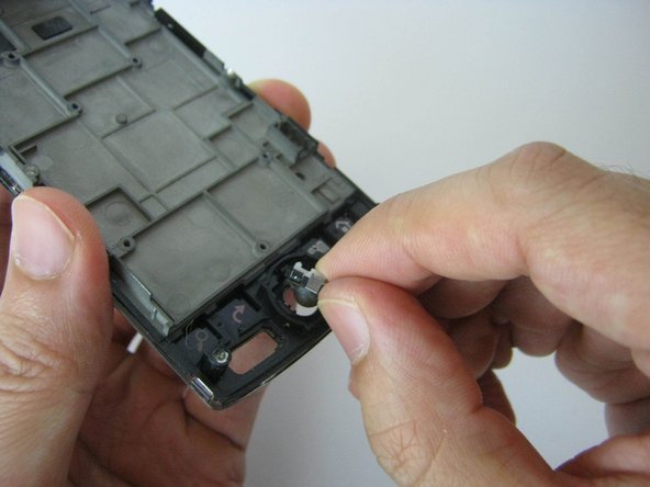

    • Remove the red Power button and green Talk button from the bottom of the casing.
    • Remove the trackball, also at the bottom of the casing.

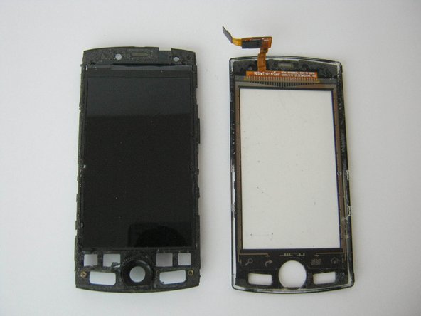

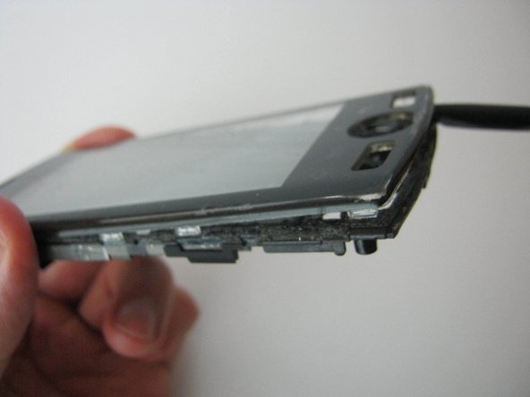

    • Pry the bottom edge of the bezel with the flat end of the spudger.
    • Carefully run the spudger up the sides until the digitizer is free.
