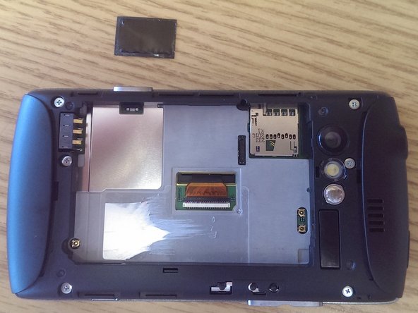

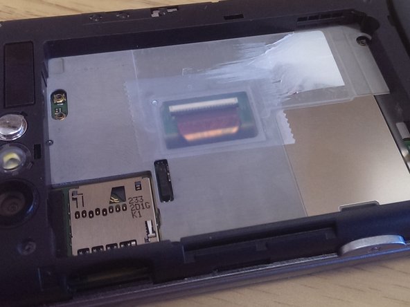

  3. Kyocera Rise Display Assembly Replacement: crwdns2935265:03crwdnd2935265:01crwdnd2935265:02crwdne2935265:0 Kyocera Rise Display Assembly Replacement: crwdns2935265:03crwdnd2935265:02crwdnd2935265:02crwdne2935265:0
    • Remove the white sticker to expose the black plastic tab that is covering the zif connector that attaches to the screen

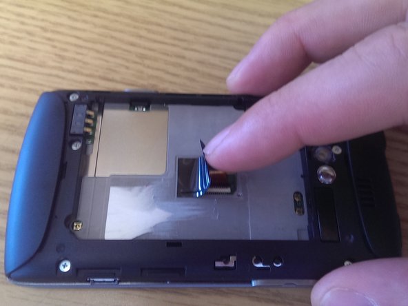

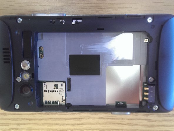

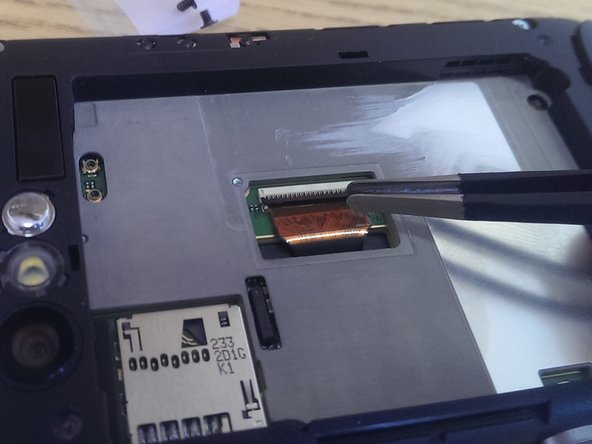

  4. Kyocera Rise Display Assembly Replacement: crwdns2935265:04crwdnd2935265:01crwdnd2935265:03crwdne2935265:0 Kyocera Rise Display Assembly Replacement: crwdns2935265:04crwdnd2935265:02crwdnd2935265:03crwdne2935265:0 Kyocera Rise Display Assembly Replacement: crwdns2935265:04crwdnd2935265:03crwdnd2935265:03crwdne2935265:0
    • Remove the black tab by first getting under it with something sharp like an exacto knife
    • Its adhered with a weak adhesive and peels away easily
    • As you can see, a hole was left open to specifically allow quick and easy mate and unmate of the zif connector

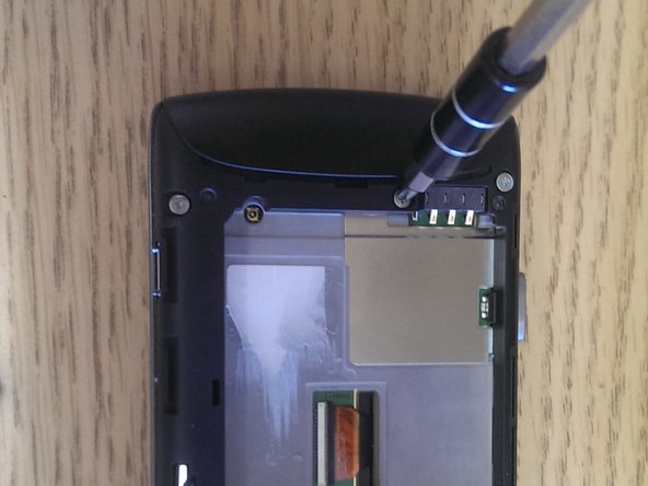

  5. Kyocera Rise Display Assembly Replacement: crwdns2935265:05crwdnd2935265:01crwdnd2935265:02crwdne2935265:0 Kyocera Rise Display Assembly Replacement: crwdns2935265:05crwdnd2935265:02crwdnd2935265:02crwdne2935265:0
    • Remove only the four screws circled in red using a Phillips #0 (PH0) screwdriver. Do not remove the others. The four circled screws hold the sliding screen down.

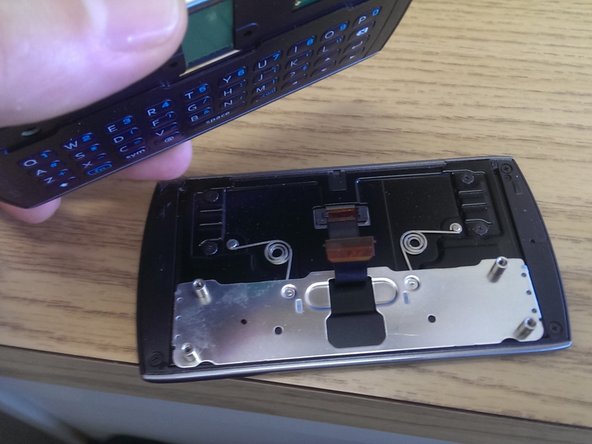

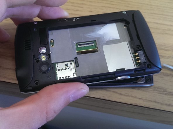

  6. Kyocera Rise Display Assembly Replacement: crwdns2935265:06crwdnd2935265:01crwdnd2935265:03crwdne2935265:0 Kyocera Rise Display Assembly Replacement: crwdns2935265:06crwdnd2935265:02crwdnd2935265:03crwdne2935265:0 Kyocera Rise Display Assembly Replacement: crwdns2935265:06crwdnd2935265:03crwdnd2935265:03crwdne2935265:0
    • Unplugging the zif (zero insertion force) connector: The flex cable is held down by a black bar that swings up. To unclamp it, run a pair of blunt tweezers underneath the cable. Twist and pull and this causes the black latch that's holding down the flex cable to open. Then the flex cable can be pulled out of the zif with the tweezers.
    • Since the screws holding the screen have already been removed, the phone keyboard containing half of the phone can be lifted away from the screen now.

    • Replacing the screen requires following the steps in reverse. Mating the flex cable from the new screen into the zif connector takes a bit of precise tweezer work.
    • The black tab that holds down the flex cable has lifted up from when the old flex cable was removed. Make sure the black swinging latch is still up! Now slide the new flex cable into the zif connector. Make sure it is lined up properly and lays flat up under the black latch. Then, using the tweezers push the black tab down onto the flex cable.
    • The black tab should now be flush against the flex cable to hold the flex cable in place and give proper contact for your screen to function properly!
    • Cover the hole with tape or the black tab that was originally there in order to keep dust out
